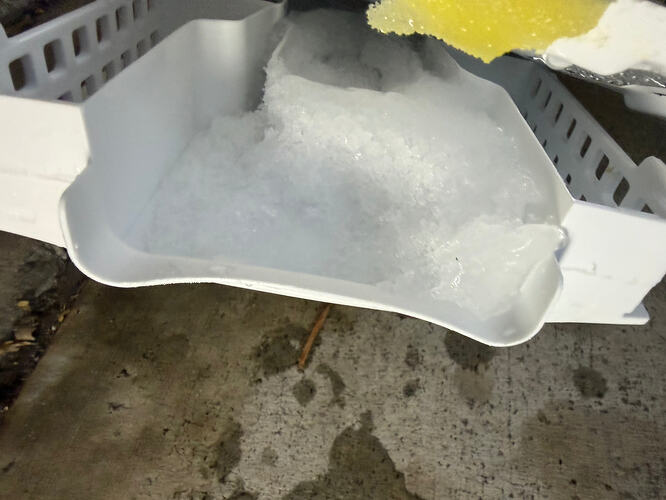

After some googling, I pulled off the back wall to the freezer and saw that that the air channel/air divertor leading from the cooling system to the fridge below was stuffed with ice. I got rid ice blockage which created the space for cold air to travel down and was hoping this would be the ultimate fix. After re-installing the back wall and putting everything back into the freezer, I felt the center vent in the fridge where air is supposed to travel down and escape through the vents but the air flow wasn’t nearly as significant as I hoped. I closed the fridge for a day to hope time would allow cold air would gather. The fridge was/is colder but not to the degree I thought it would be, especially since I adjusted the temperature colder than the “recommended” setting.

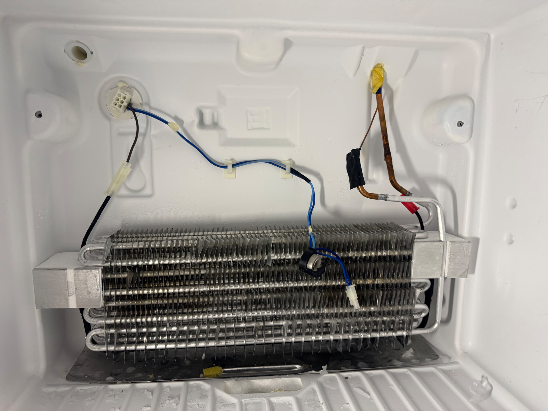

Today (about one week after trouble shooting), I noticed the fridge warmer yet again. Removing the back wall to the freezer, the air divertor was once again blocked with ice. However one difference is the cooling fins had ice on them whereas last week they did not. I don’t know if this means anything.

The frost you saw forming on the evaporator this second time is an important clue. A healthy evaporator should have a light, even coating of frost across nearly the entire coil. If it’s becoming packed with ice over several days, the automatic defrost system may not be melting the frost as it should.
First thing I’d check
With the evaporator cover removed, look closely at the evaporator coil.
  • Even light frost across the entire coil: The defrost system is probably working, and I’d look more closely at the drain, airflow, or an air leak.
  • Heavy snow/ice covering the entire coil: Strong indication of a defrost system failure.
  • Only one small section frosted while the rest is warm: This points more toward a sealed system problem, although that’s less likely since your freezer is still freezing well.

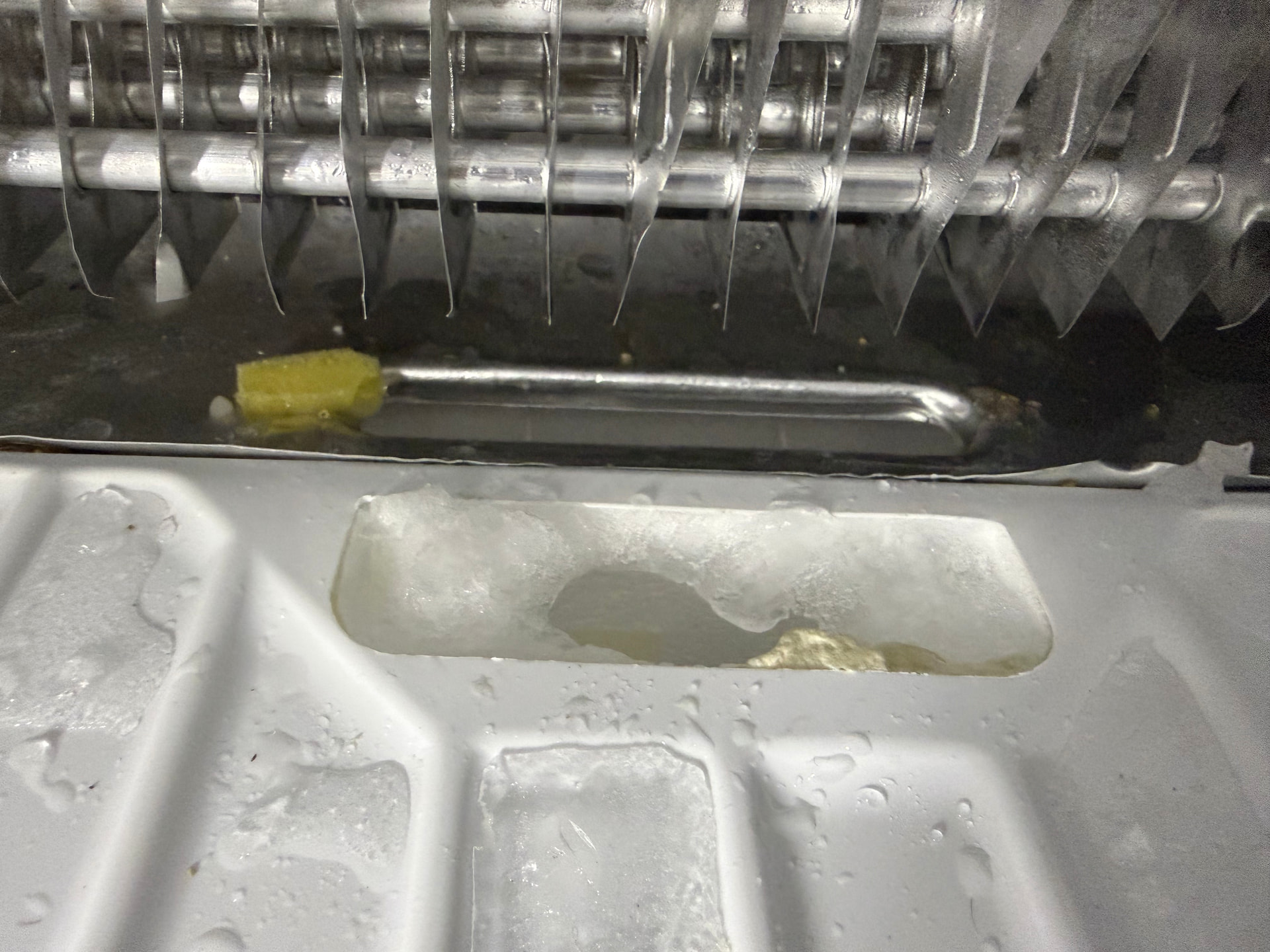

you may have a clogged defrost drain tube. It is a hole in that silver tray under the freezer coils. On yours it is in that slot directly behind the air passage to the refrigerator. That hole connects to a tube that drains the water that comes from the defroster melting the frost build up on the coils. If it that hole or tube is blocked the water builds up and refreezes, getting thicker on every cycle. Eventually it overflows that tray and and can clog that passage and build up around the coils blocking proper air flow.
Try pouring a little water in that tray and see if it drains and let me know

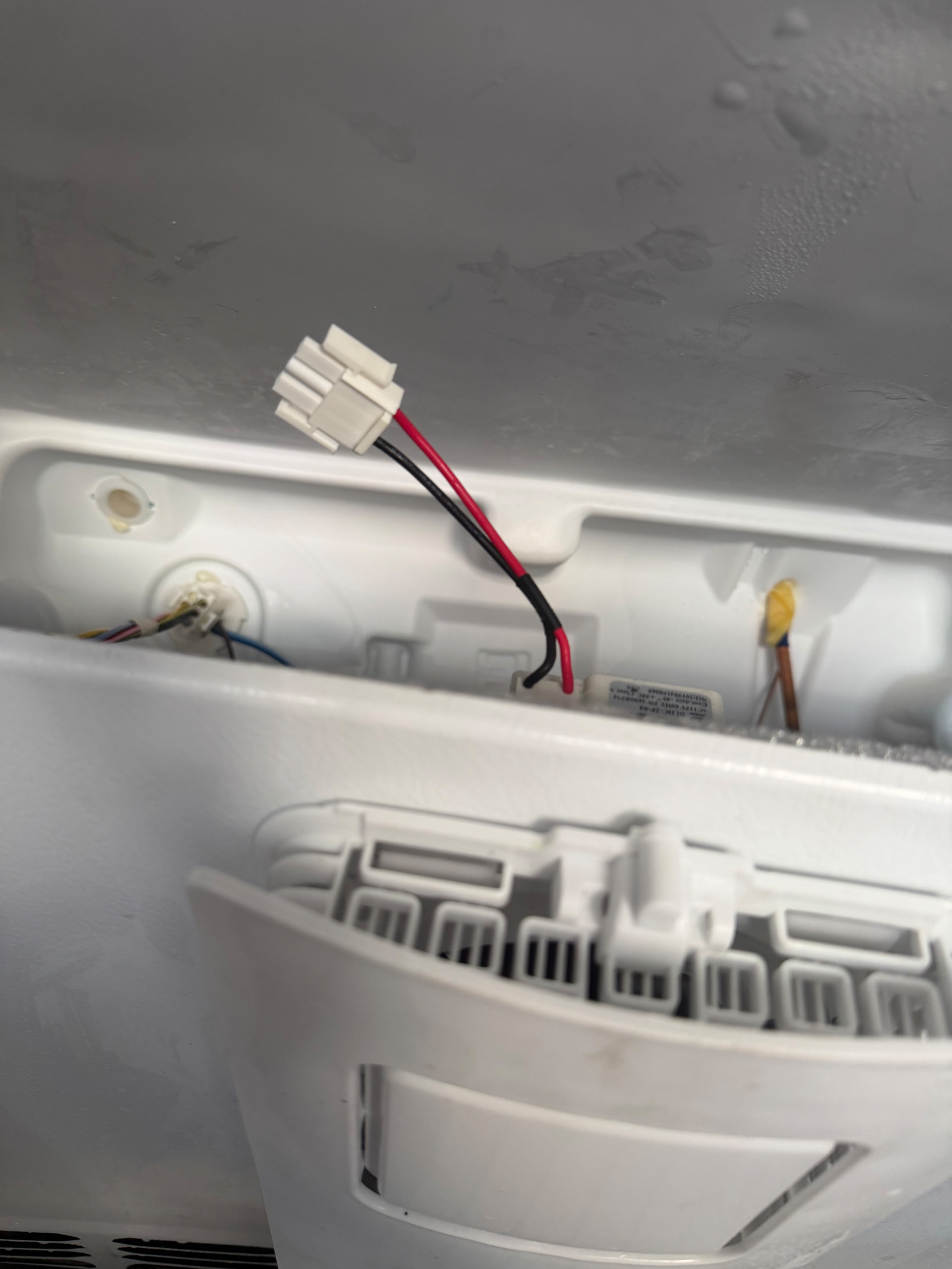

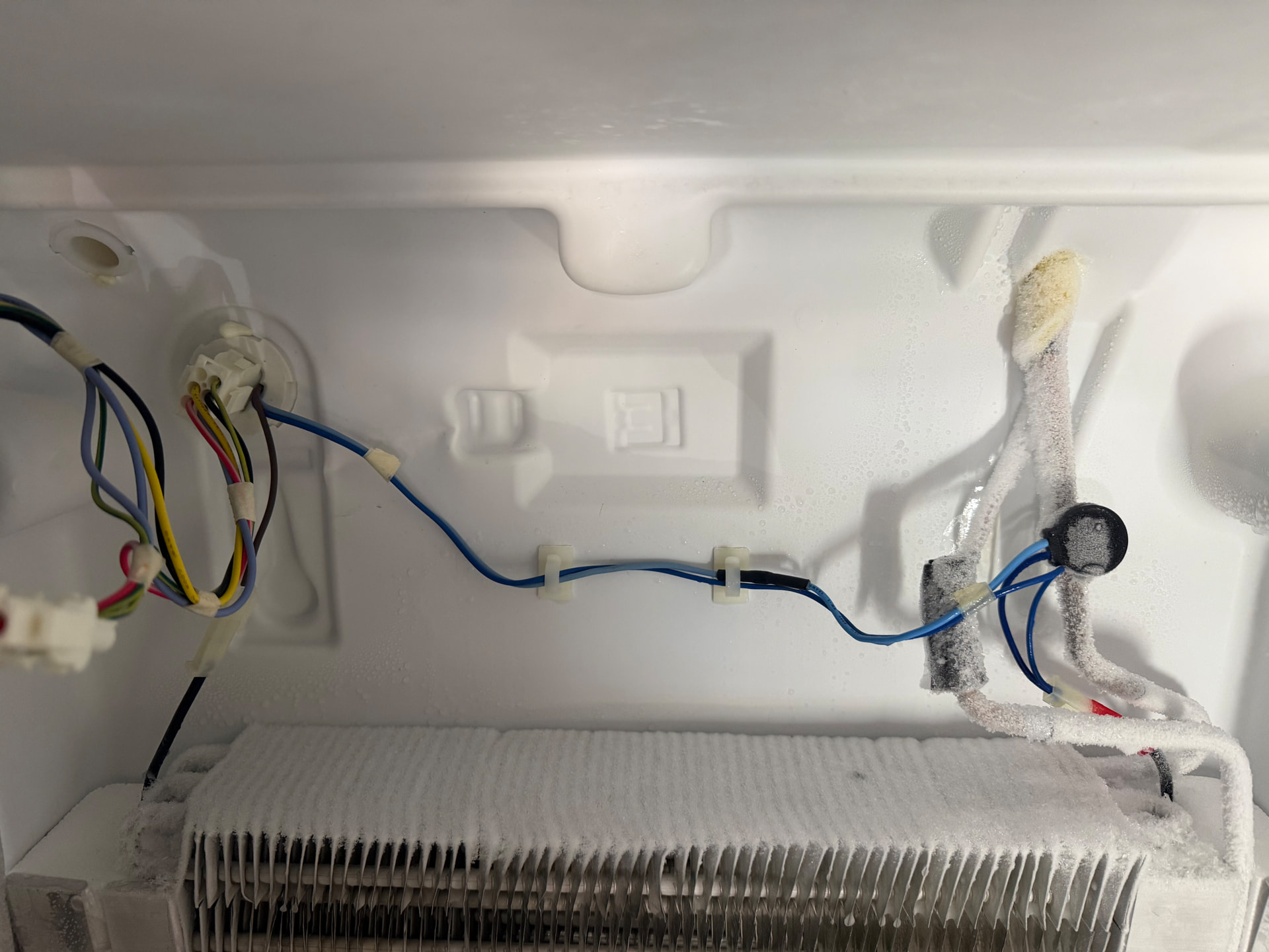

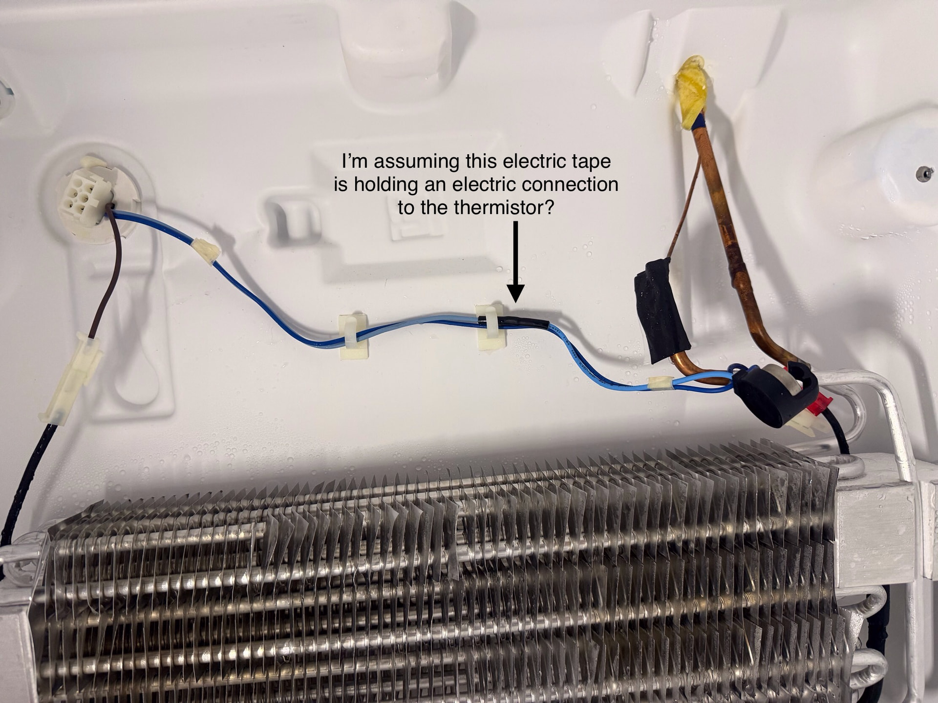

Below are the pictures of the top freezer after the back panel has been removed. As you can see that after a day, there is a bit of frost buildup on top fins and pipes. The damper and drainage holes are largely unobstructed but I did pour hot water down both of them. I tried to look at the drainage pan where the water should be going but couldn’t find any indication that it was settling anywhere. I pulled off the front kick cover to see a pan in the right but it was still very dry. The area behind the fridge, where the compressor is, was dry as well.

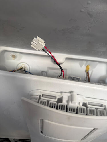

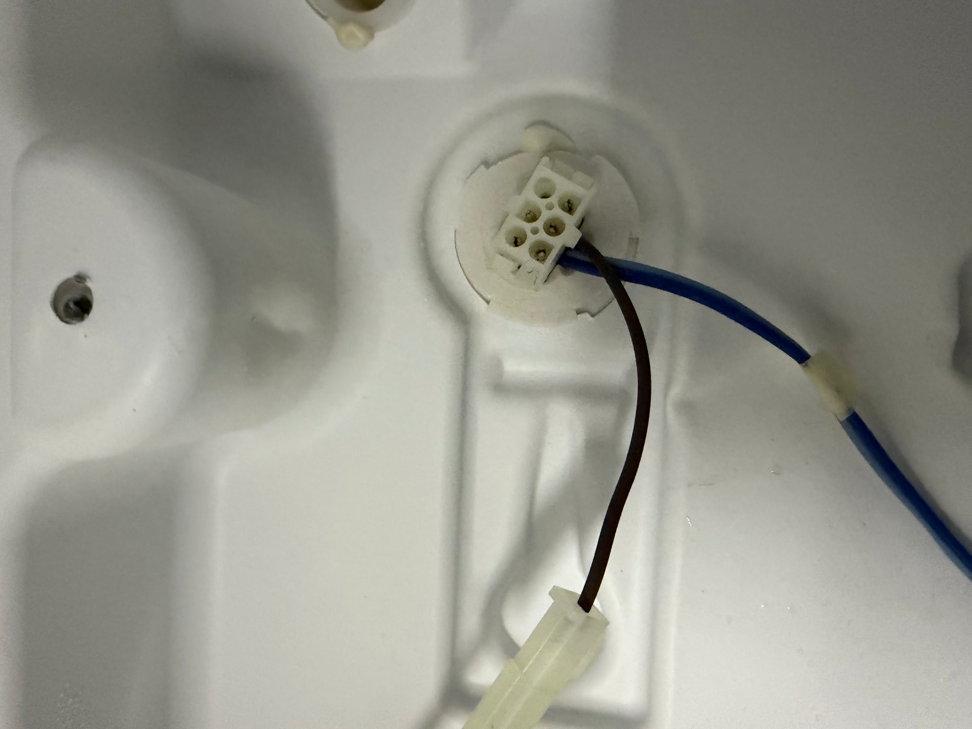

Since I had my multimeter out and just figured I would guess test whatever wires I conveniently saw before I put the back panel back. I unplugged the evaporator fan, matching red with red and black with black on the multimeter and got no signal, just OL. Then I tested the back wires where the fan plugs into and received a reading above 6 ohms. So for the moment, I’m assuming the evaporator fan is my only problem(?) I hope it 's not something else like the thermistor.
It is entirely possible it is the fan motor ( Frigidaire 5304521244 Top-Mount Refrigerator Refrigerator Evaporator Fan Motor | Genuine OEM Part )since you read an open circuit instead of resistance (OHM’s)
