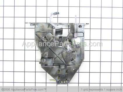

OK Gene..after your help with my dishwasher earlier this year I am ready to order the hinges. I assume I order two. (They do not come in pairs I beleive) Another question before I order the hinges. The light used to go off if I wiggled the door shut..now it never goes off and I can’t figure out where the “switch” or the sensor is in the oven. Any help here would br much appreciated. Heymate

The light switch is a part of the door latch assembly (the pin on the left side).
