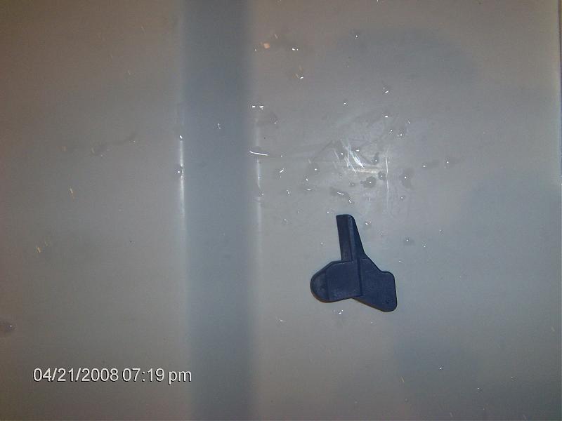

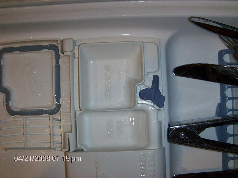

The soap dispenser release lever snapped off. Is there a replacement part or do I need something more involved? I have attached some pictures to better describe my dilema.
Thx,
Mark
The dispenser for that unit is only available
as an assembly.
[FONT=Times New Roman][SIZE=3][COLOR=#800080]http://www.appliancepartspros.com/part_details.aspx?part_id=3776575[/COLOR][/SIZE][/FONT]
Glen65 is correct. That is the only way to repair it.
The good news is though that this is a easy repair and something you should be able to do yourself.
