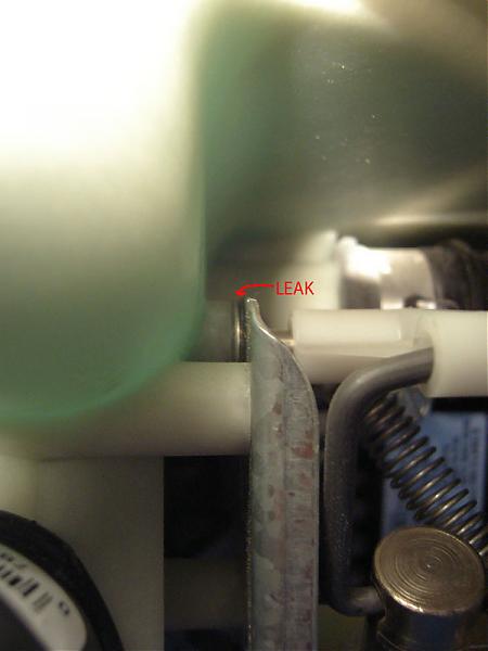

I was given a Jenn-Air Quiet series DW731W dishwasher that was being replaced because of a Kitchen upgrade.. its replacing our GE hunk of Junk that was installed when we had our house built. (Jenn-Air unit was functioning perfectly when it was removed)

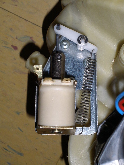

However the unit did not function correctly for me when I put it in, after some poking around I noticed that it was missing the Spring Return for the Solenoid pull. Once I got that on (look at image and tell me if the spring is in the correct spot) the dishwasher ran through its cycles correctly.. However there was a slow leak, I could not tell where it was coming from so I put some Food Coloring in the water and found the leak quickly after that (see image)..
What do I need to do to fix this leak, any ideas would be appreciated. I am currently laid off and would like to do this myself if possible.

Does sound like the seal needs replacing.
thanks for the info Denman..

Given that your post is more than a year old, this won’t help you, but may be useful for someone else. I had my Jenn Air DW760B apart to replace the flapper and figured I’d take a picture of the spring position for the forum. I assume you already figured out that the location you had it in was incorrect; you can barely make out the spring in the parts diagram, but it does show the right placement for it.
The photo below should give you a good idea of how the spring is mounted.
Jerry
paddiwack,
Yea I figured it out, much easier to see it out like that :slight_smile:
that picture will help if anyone has the same issue..
