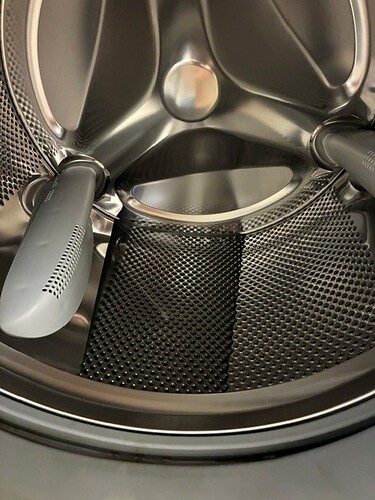

Slow leak into chamber for Bosch Vision 500 series front loading washer
Brand: Bosch
Model Number: WFVC6450UC/29 (in operation in my household for 17 years)

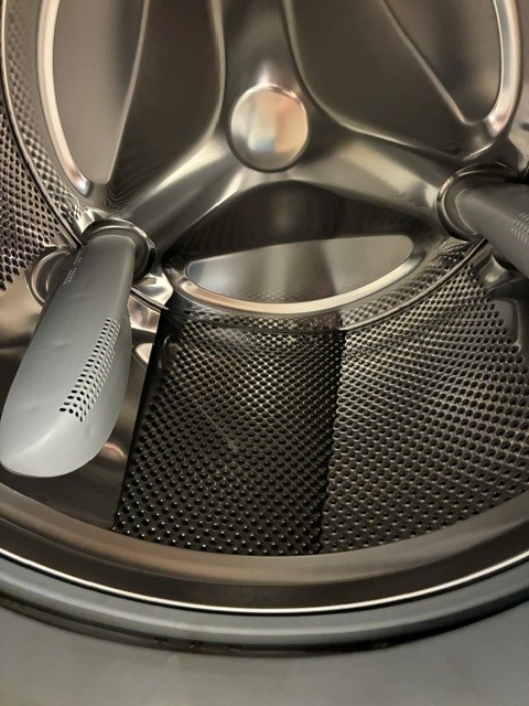

Main Symptom: leaking water into chamber very slowly the amount you see in the pic took maybe 10 hours
What happens & when: happens when NOT using washer but water supply turned on
Probably inlet valve? Hot or Cold I dont know how to tell my shutoff controls both hot and cold together so cant troubleshoot that way. Water cold to touch but that probably doesnt mean anything since the leak is so slow
If inlet valve how easy for DIY for me to fix it I cant get myself to call the local place if I can avoid it probably charge an arm and a leg including for the part.
