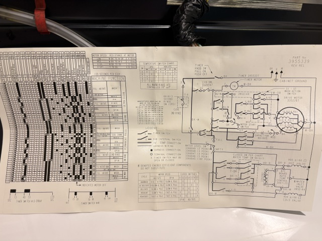

I’ve attached the pictures.
Excellent — that is the wiring diagram I wanted. The second photo confirms this washer uses the multi-speed motor and speed-selector circuit, so we can test this without replacing parts.

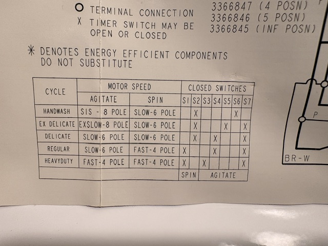

One thing I don’t want to do is give you a guessed continuity combination from that photograph. The contact chart in your tech sheet is visible, but the photo resolution isn’t quite high enough for me to reliably read every terminal designation.
Take one close-up picture of just the “SPEED SWITCH”/switch-contact chart on that tech sheet. Fill most of the picture with that small chart. With that, I can translate it into a simple meter table showing exactly which two terminals to probe in Normal, Heavy Duty, Delicate, etc., and what Ω reading you should get.
I tried the first test the Spin speeds are the same. I took a couple more pictures.
Yes — this close-up gives us the factory switch chart. We can now narrow this down properly.
For this machine, the tech sheet calls your Normal setting REGULAR:
Selector Agitate Spin Factory closed switches
Handwash Super Slow – 8 pole Slow – 6 pole S2, S6
Extra Delicate Extra Slow – 8 pole Slow – 6 pole S2, S5, S7
Delicate Slow – 6 pole Slow – 6 pole S2, S4, S7
Normal / Regular Slow – 6 pole Fast – 4 pole S1, S4, S7
Heavy Duty Fast – 4 pole Fast – 4 pole S1, S3, S5, S7
Notice something important: Normal and Heavy Duty both use S1 and S7 for the fast-spin circuit. The difference between those two settings is primarily the agitation-speed selection.

The spin speed should be essentially identical on Normal and Heavy Duty.
If by “rinse stays slow” you mean the washer agitates slowly while it is rinsing, that is not necessarily a failure. The knob’s second speed refers to SPIN, not the agitation occurring during the rinse fill/agitation period.
In other words:
NORMAL — SLOW / FAST
means:
SLOW = agitation motor speed
FAST = spin motor speed
It does not mean slow wash agitation followed by fast rinse agitation.
So if your complaint is:
“Normal agitates slowly during wash and also agitates slowly during rinse, but then spins fast.”
That is normal operation.
But if your complaint is:
“Normal agitates slowly and the basket also SPINS slowly, while Heavy Duty spins fast.”
Then we have a fault, and we’ll test the speed switch/timer circuit next.
Based on this factory chart, that’s the distinction I’d establish before replacing or even condemning the 3953144 speed switch.
Ok I follow you. That’s my concern is the rinse agitation speed is different per these selection between Normal and Heavy Duty. However, the spin speeds seem to be the same.
