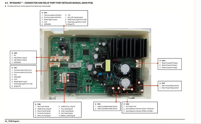

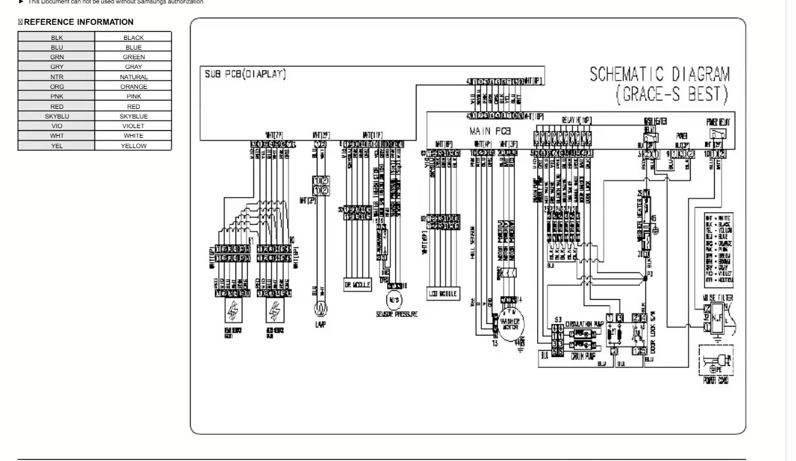

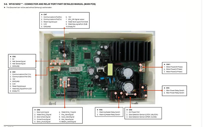

Yes—but I’d change the test slightly so we know exactly what the board is doing.
On the WF457ARGSGR/A2, Samsung specifies the door-lock output as 120 VAC when the control is commanding the door to lock. The technical sheet identifies the board-side test as CN6 pin 1 to RY5 pin 2. ManualsDir
If you test at the door-latch harness, I would not simply unplug the latch and probe random terminals with the door open. Ideally, back-probe the lock connector while it remains connected. That keeps the latch and door-status circuits in their normal condition. Set the meter to AC volts, close the door, start a normal cycle, and watch for approximately 120 VAC when it should click and lock.
The result is very useful:
  • About 120 VAC reaches the lock, but there is no click/lock: the door-latch/lock assembly is bad.
  • No 120 VAC until you do your Delay Start → Cancel trick: that strongly points away from the latch itself. The control is simply not sending the lock command under normal startup.
  • 120 VAC appears only after Cancel and then the latch clicks: that would be especially important given everything you’ve already replaced. It would tell us the latch is capable of operating and the problem is in the control/logic sequence rather than a mechanically failed latch.
Samsung’s own troubleshooting procedure follows essentially the same logic: check the door-lock coil output; 120 V with no lock → replace the lock; no 120 V → troubleshoot the PCB/control circuit. ManualsLib
Since your machine has this unusual behavior where canceling Delay Start suddenly allows it to operate normally, I’d do two voltage checks: once when you press Start normally and it refuses to start, and again immediately after doing the Delay Start/Cancel procedure that makes it work. That A/B comparison may finally pin this down.
Be careful here—the measurement is live 120 VAC, so keep the probes secured before initiating the test and avoid touching the connector terminals while powered.

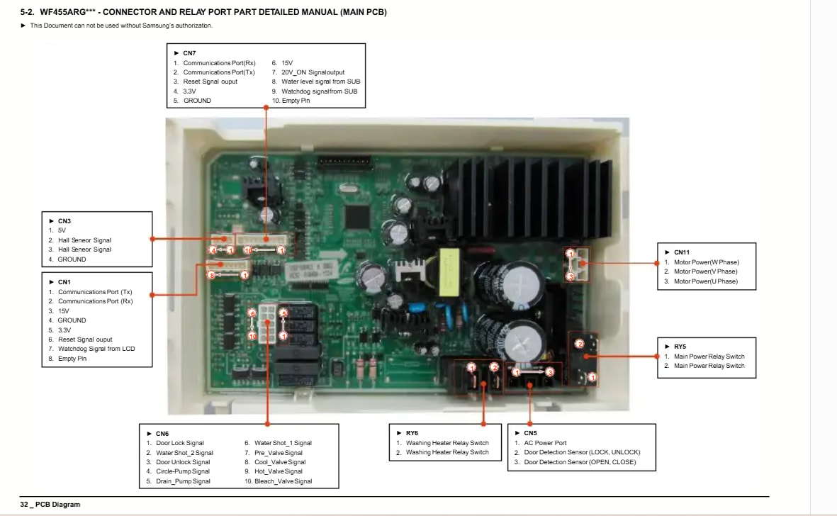

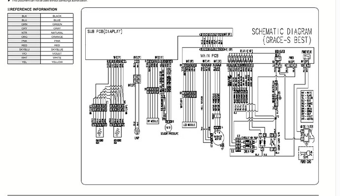

Well, I could test on the board but no idea how to tell which is pin 1 and pin 2. And if the harness is unplugged from the board, it would not be inappropriate “normal” state. Maybe I am over my head with testing if it should be obvious because I don’t see an indicator of pin numbering. As for testing at the lock harness, it makes no sense to me of how to test at the harness with the door closed, unless it is from the top and there is no way to get in there. Other than that the tester leads would have to be closed in the door and water would start without the rubber ring in place. I’m sure I’m missing something.
After doing the cancel workaround, it sounds like the water starts (or something does) before the door locks. Again, there is no indication of the door locking without doing the cancel workaround.
It makes the most sense to me from what I have read is that the programing is “stuck” in delayed start mode, but I have replaced all of the boards that I know of that could possibly store that setting.
I also read somewhere in a thread that it could be possible that hitting cancel can possibly send enough more current to the lock to make it work (but again it seems to lock after something else starts.
At this point, it seems I have three choices. 1) keep doing the cancel workaround until that fails and then get a new washer. 2) Call a service repair person, which I can rule out based on availability and exorbitant cost with no guarantee of repair. 3) Replace the door lock mechanism and hope that it mysteriously resolves the issue. (I believe it is about a $50 part).
I appreciate your help and wish the testing made sense to me.
Thanks for the diagrams. I will clearly need to unplug the 2 harnesses to do the test and I will when I have another person to help push the button while I hold leads. I suspect there will be no voltage when I push start without the cancel time delay. It is not attempting to start. It sounds a “chime” when start is pushed maybe like it is an error? I did one more test: I checked the time when going into the time delay screen and it seems to default to a time a few minutes before the current time which would make the start time the next day (which I am guessing is invalid). I changed the time to a couple minutes after current time and pushed start without hitting cancel and it operated as expected; locked the door, delayed for a couple minutes, and started and completed the cycle.
