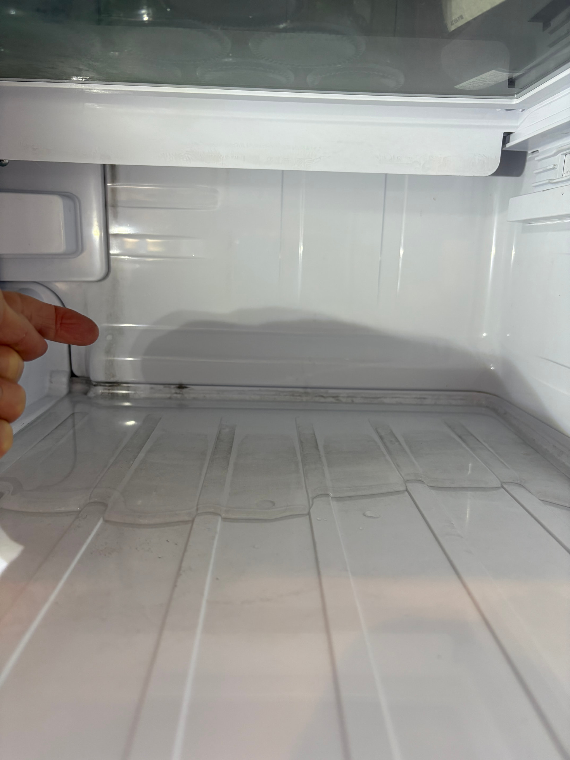

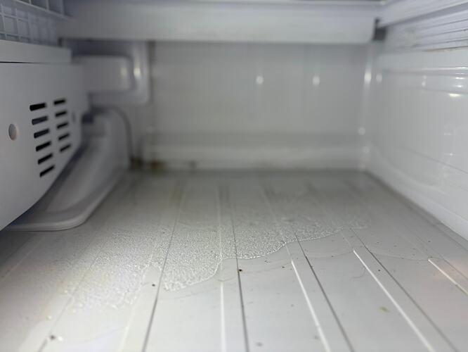

This is an update for the technicians to my question sent yesterday. We were never able to initiate a manual defrost, but turning off the breaker for 20 minutes has kept the bowl of water I put in the flex drawer as a test not to freeze. But I will explain why the freezing in the flex drawer and refrigerator is not fixed. A month ago, all the produce in the flex drawer froze and remained frozen for a couple weeks. We were going out of town, so I just left the frozen produce in the flex drawer. When we returned the produce had defrosted and was slush. We get a lot of power outages where we live and I believe that a power outage allowed a reset or something to defrost in the unit allowing food in the flex drawer to defrost. After returning, I threw out the spoiled produce and put fresh produce in the flex drawer which started to freeze again. Turning off the breaker (or power outage) keeps food in the flex drawer from freezing for a short while, but eventually the food starts freezing again. I am attaching photos taken today showing frozen water in the bottom of the refrigerator cabinet (just under the vegetable crispers) with refrigerator set at 45 degrees and freezer at 2 degrees. Please note where my finger is pointing that it appears to be mold on the back wall where water has run down the back wall, indicating this problem has been going on for awhile. My suspicions are either the motor on the damper door is not working or the damper door is being frozen open or the temperature sensor is not functioning but we would like your detailed input on what to test first. My husband has several Fluke meters, was an electro/mechanical technician and has repaired our washing machines and electric ovens down to board level. We purchased the Samsung service manual for this model (RF4287HABP/XAA) but need your assistance on where to start.
Update: I removed the ice from the bottom of the refrigerator cavity to expose the pool of water underneath. I came back several hours later to clean up the pool of water but it had drained somehow. I used full strength white vinegar and a white nonabrasive scrubbie pad to clean up what I thought was mold, but it did not come off so it does not appear to be mold. Waiting for your direction to diagnose the problem. Thank you!
These had a know issue with the fridge section drain getting clogged, causing ice build-up on the fridge evap, water under the crispers, and causing the fan to stop, but that usually results in a no cooling situation.

Thank you for sending these troubleshooting steps. We haven’t had a chance to try it yet. In my previous messages, I described and sent photos of the pool of water and ice that was sitting in the bottom of the refrigerator cabinet (under the crisper drawers). I cleaned the water up a week ago and checked it a day or two later and no water had returned. But last night, I removed the right crisper drawer to see if the water had accumulated again and IT HAS! This time there is a pool of water but it was not frozen like last time. I am attaching new photos and as I mentioned previously, please notice where my finger is pointing in the photo to the dark discoloration on the back cabinet wall where it appears the water is flowing in from. Where is this water coming from? And what is causing it to do this? Please send troubleshooting steps and/or page references to the service manual for this model. Thank you!

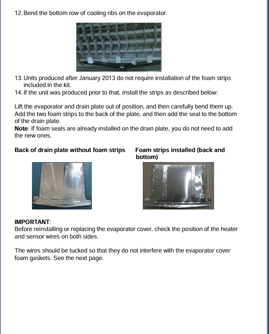

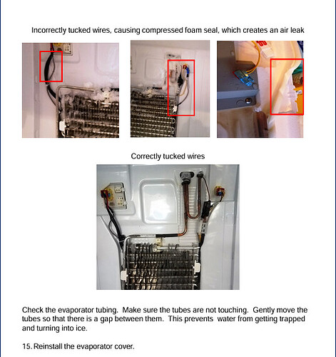

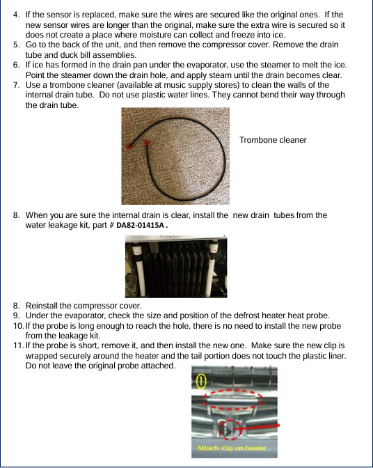

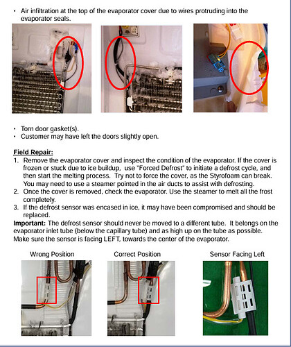

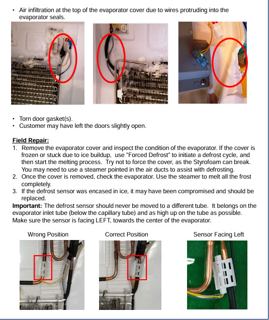

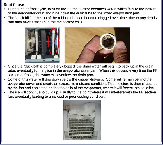

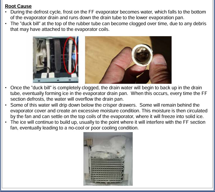

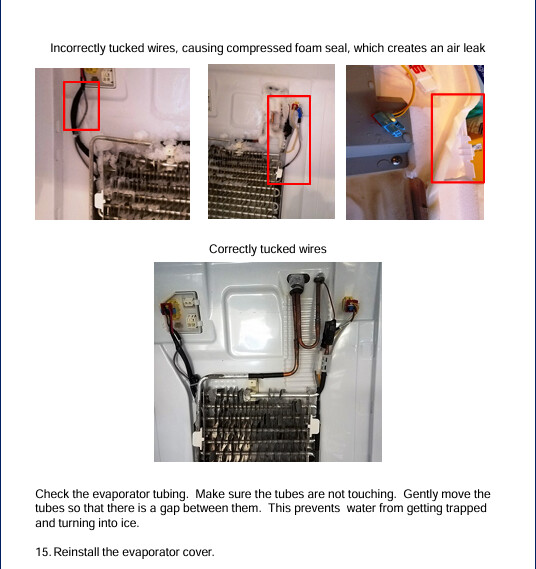

There is actually a known issue of that with these. I can’t share the full thing as a document but here are the screenshots.
I will also say that the issue you are experiencing with the middle drawer is probably exacerbating the water under the crispers in the fridge section.
