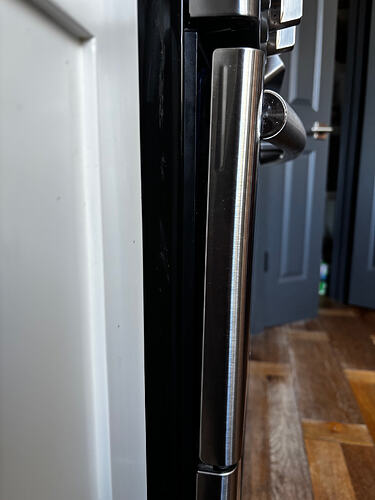

Samsung NX58K9850SS/AA oven door will not sit flush anymore and triggers door open warning. Will part DG94-01273A fix my issue?
Brand: Samsung
Model Number: NX58K9850SS/AA
Main Symptom: Door will not sit flush at the top anymore and constantly triggers the door open light and warning message that the door is open
Parts or tests already tried: I think part DG94-01273A may potentially fix the issue but not sure. Would like confirmation given the pics we have uploaded.
With the door not closing all the way, the hinges would be the correct part to replace.

Thank you for the replies. It is the same on both sides although i only took pics of the left side due to shadows. I will order 2 and see if this fixes my issue after install. Much appreciated!!
Hi - I installed the 2 new hinges, and it did not resolve my issue - the door still does not sit flush. Any other ideas or culprits? Thank you

Thanks - we already viewed the video. The difference is that the video shows a single door vs ours is a double door with divider. The only thing i can think of is that the dividing plate in the oven was backwards where the divider marked as “Front” was actually in the back. I suppose it is possible that that door got somehow warped because of that but everything looks good in terms of the gasket liner and the door locking mechanism is not preventing the door from being closed all the way as far as we can tell. The door doesnt appear to be unlevel though.

I did and it is still not fully closing. I actually removed it for now to see if that would help, which it didnt. Is it possible that the posts inside the oven (which the door hinges attach and lock into) are off?

I took a small level and when the door is fully open, it is definitely not level and lower towards the top of the door, which would make sense why a gap near the top when the door is shut. I also dont think it has anything to do with the door hinges for the top half of the door as things snap and lock fine when holding down the latch and opening that top half door.
At this point I would say there is a strong possibility that the posts are damaged in some way
Do you know if the posts should have some play, or should it be solidly locked in place. When the door is off, i can move it slightly side to side (not so much vertically) without much force.
Also, it doesnt appear to be a repleable part anymore based on the URL i provided in my last update? Or at least i cannot find the exact newer part.
I would say the play you are experiencing and the fact that the door hangs down at the topo when opened is a pretty fair indication that those posts are damaged and regretfully they are not serviceable
ok, bummer - if by any chance it is related to the inner gasket, how badly damaged (or in what way) would then need to be damaged to where that would be the cause. I am just trying to think of other root causes which could be impacting this. I honest dont know if it is the posts themselves as there is no vertical play (only slightly sideways)
I found what i think are the parts elsewhere online, but not sure since you say its not serviceable (or perhaps you mean the part is no longer available for sale on AppliancePartsPros.com
We don’t show it as a serviceable part from the factory documentation, As far as damage to the pins that can be caused by a lot of things including wear and tear
