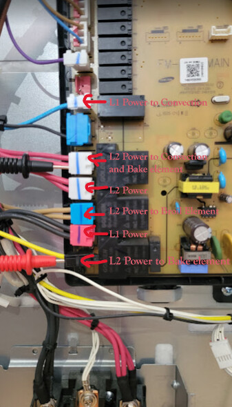

I have not been successful at figuring out why the lower oven on my stove will not heat. I tested the 2 oven temperature sensors by checking continuity and resistance values. I tested continuity on the Range High Limit Thermostat. I tested continuity and resistance on the lower element and it is fine. I even wired the lower element using the upper element wiring and was able to get the lower element to heat the lower oven. I test voltage at the wires leading to the lower element and the voltage is always 0 VAC. All other parts of the stove are working. I checked error codes and I see “C-f2” in the list of 5 latest error codes. This may have been from me unplugging the user interface control board during trouble shooting. See below.

Check at the main control board from the bake relay to the broil relay to see if there 240 Vac. If there is power but no power at the element then there is a wiring issue that will need to be corrected. If there is not voltage but voltage into the relays then this will be a board issue.
Can you specify where to test? What terminals?

I cannot find RY203 and RY204 on the main board but I do find EY203 and EY204 connectors shown here
When the oven is off I see 120VAC at these terminals. When I turn the oven on, I see 0VAC. Is this a correct test?
It does not show exact points to test but if you follow the wires back from the bake element to the board then test at those points.

Looks like you are testing the wrong one. Test at the yellow wire at the bottom to the 3rd relay from the bottom. Here is a picture that shows it.
Sorry. This is challenging to understand your direction, but I really appreciate the help.
Are these the correct locations?
When the oven is off, I see 120VAC. When I turn the lower oven on Bake, it drops to 0 VAC.
When I test from these terminals while the lower oven is on Bake, I see 0VAC.
I think that I should see 240VAC if the Bake Relay was working. Is that correct?
Further, if I put one lead from my meter on the yellow wire and the other lead to the oven chassis, then turn on the lower oven to Bake. I see 120VAC. If I put one lead from my meter on the red wire from the white top white connector (as shown above) and the other lead on the oven chassis, then turn the lower oven to Bake, I see 120VAC. When I cycle the oven off, the voltage goes to 0VAC. Does that mean that the relay is working? If so, why would am I not getting 240VAC at the lower element?

If you go across both connectors and test for 240 vac. If there is not 240 vac then the board is the issue. If there is 240 vac then check the wiring.
These Connectors?
Yes, that would be correct.
