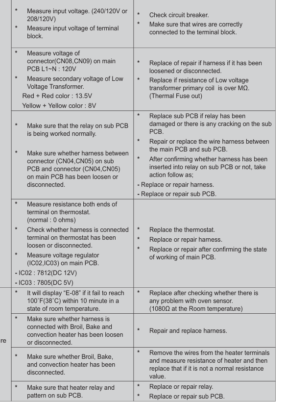

I look at both parts physically, main board and display board, nothing physically damage appears.

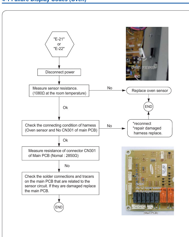

I check the resistance of the main temperature thing 1090ohmns (should be 1080 ohmns as per the tech sheet).
Do you suspect the main board or display board?
Should I just order both of them, and if one works, return the other?

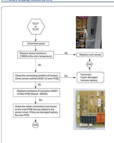

1 - As mentioned RES was 1090, I will recheck.
2 - is the oven sensor connector on main PCB, is the white plug in your second picture on the main? Pin 1,2 and 3,4??

Hi Matthewferreira2,
It seems like the main control board may be the issue, as it controls many of the oven’s functions. If the control board has failed, it can prevent the oven from operating properly.
