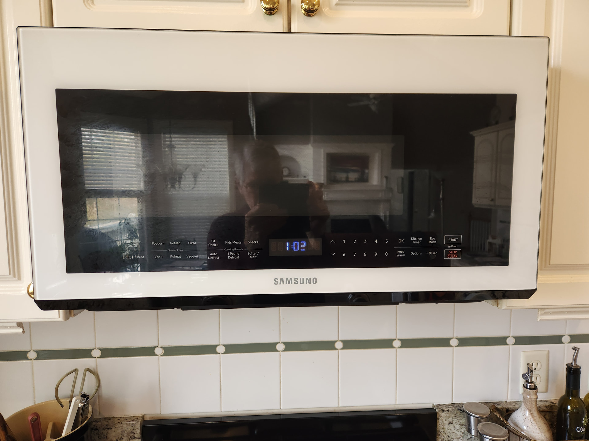

Brand: Samsung
Model Number: ME21B706B12
Main Symptom: Microwave
What happens & when: No error codes. Unit functions perfectly normally except that one segment of one digit of the display has failed (see photo). It failed gradually over about a week, gradually getting dimmer until going out completely. Is this likely the display itself, or the control board? What is the smallest replacement part I can buy to fix this (hopefully not the entire door assembly)?
Since it is the individual LED that went out, the failure would be in the display PBA module. Here is a link to the part information page for the display PBA module used with this model. DE92-04290C Pba Module Assembly For Microwave-Hood Combo | Genuine Samsung OEM In Stock
Same thing happened to mine. The fix for this is unfortunately not worth the cost and effort.
