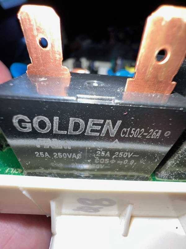

Do you believe it is possible that one of the relays has gone bad and could be replaced, so the old board could be used as a backup?
is there any way to test these?
