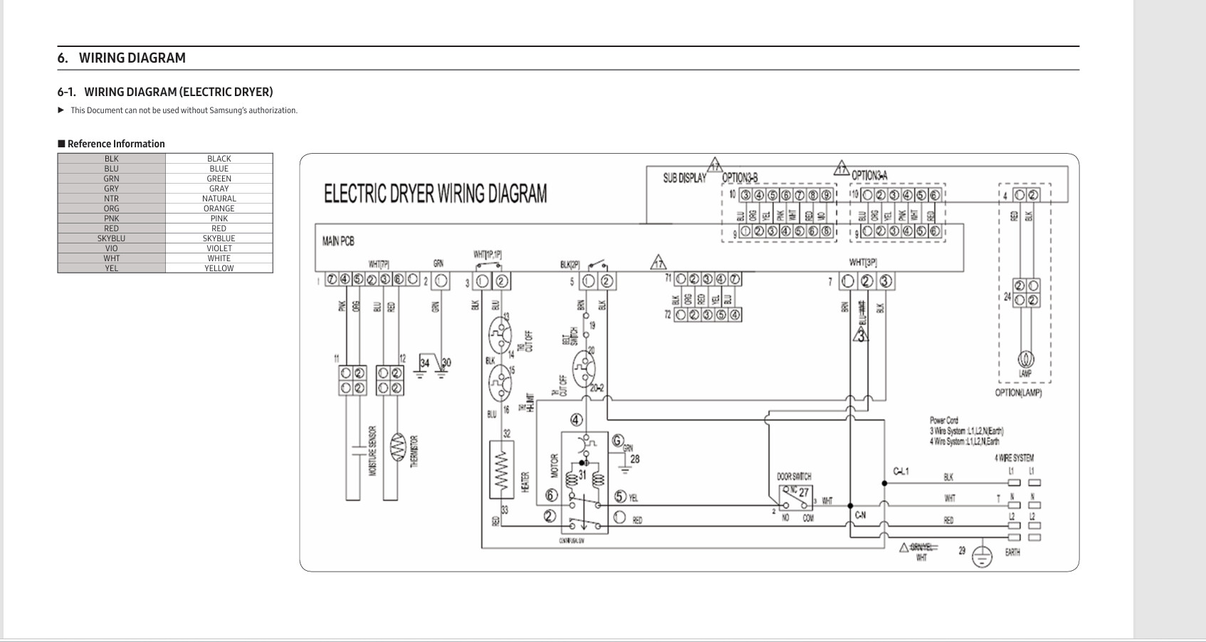

Samsung DVE45T3400P won't get hot when running
I have been trying to fix our electric dryer. I have changed the heating element, thermal fuse, dryer thermistor and thermostat. I have also checked the incoming 240v power and each leg tests good. I checked the control board with a multimeter and got 120v from the L1 side of the heating element. I have no idea what else could be causing this issue

There are two sides to chase
One side of the heater circuit is supplied through the control-board heater relay.
The other side is completed through the motor’s centrifugal switch once the motor reaches operating speed.
That’s why a dryer can run and tumble perfectly normally but never heat if the heating contacts inside the motor centrifugal switch fail. The motor can still operate even though that separate heater contact isn’t closing.
Since you’ve already found 120 V on one side, check each heater terminal individually to neutral while it’s running and calling for heat.
If one side has approximately 120 VAC and the other side doesn’t, trace the dead side backward.
If the dead side traces toward the control board, suspect the heater relay/control board.
If it traces toward the motor, suspect the motor centrifugal switch, wiring, or connector.

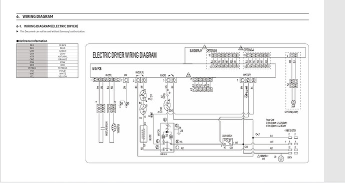

Do you have a wiring diagram/schematic for this dryer?
