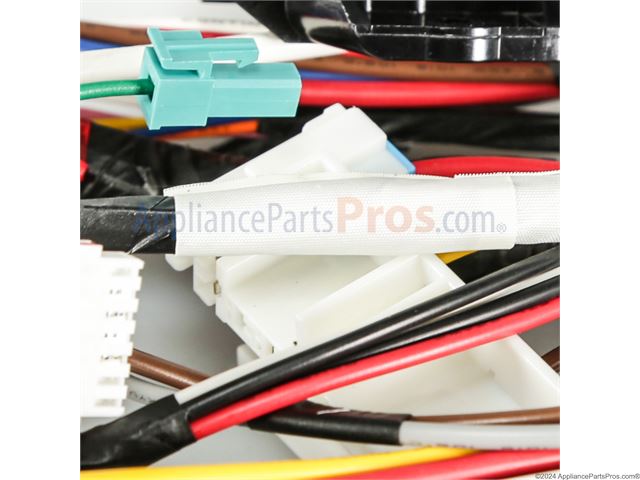

If you check the black wire at the motor relay to chassis ground are you getting any voltage?
I don’t remember exactly but I think I checked that as well and was not getting any voltage
If you’ve got voltage at the terminal block but not at the board, especially if you are missing L1 voltage when checked to chassis ground, then you’re looking at a wiring issue on the main harness DC93-00466A. If you had voltage to chassis ground but not to neutral at the board then I’d suspect a bad door switch.
