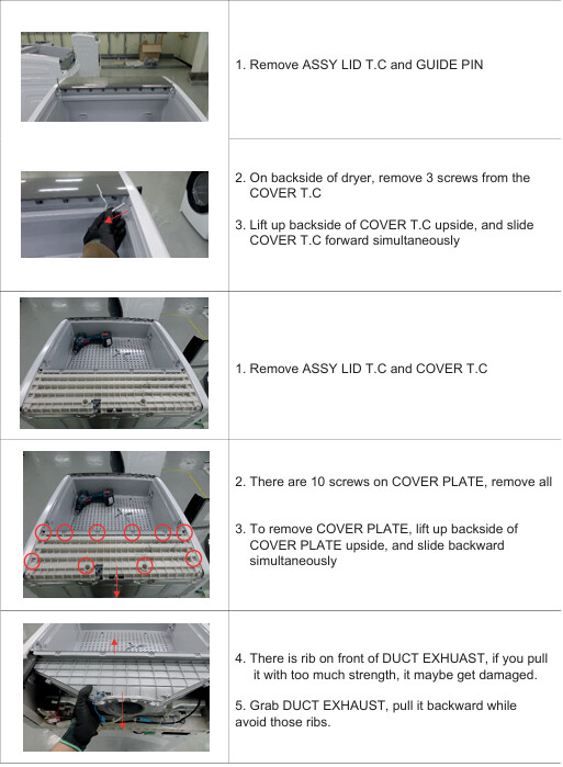

The main dryer duct would be accessed by going through the front. The top dryer blower section would be accessed by removing the lid, followed by the top cover behind the lid and a cover plate just underneath that. Here are some images to help with the top portion.
Dumb question but if there is lent on the top dryer filter (I didnt know there was) can it trigger the vent light while using the bottom dryer even if the top is not on drying? Thank you for the pics by the way!
While it should not cause this issue, I have seen where an issue in one section unrelated to another section caused a failure that did not point to the original source. Checking the upper section is to eliminate the chance that this might be one of those cases.
I was reading the upper and lower share the same vent. My model has the vent on the top like in the pictures?
From what I am able to tell, yours will have a similar set up as what is in the pictures.
