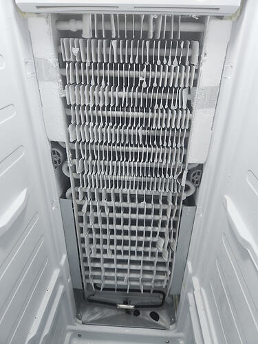

The next step as I understand it is to look at the rear panel to see how much frost is there. Does that mean take off the cover panel? There is no frost on the outside of the panel. There was no frost when I took out the food. Perhaps there was frost that ended up on my floor this morning? Either way, no frost noticed and fan is running. I think the next suggestion was to check the compressor.
let me know the next steps
I’d still be interested to know if the evaporator is iced up limiting airflow, so if you could take the back cover off and let me know what you see
Here’s what we’ve got. Seems like a normal light coating, but this is the first I’ve ever seen one
Yeah that’s perfectly fine. No air flow restrictions, fan running and compressor is cooling. I really think it’s the damper assembly
That image was hours after the symptom showed up. I went out, came back, and looked in the freezer. That grate is clean of any ice. I am hesitant to put in another damper since it might be or might not be the problem. Might have to buy a new model. Drat. Thanks for your help though! If there’s any other tips, I’d like to hear them
