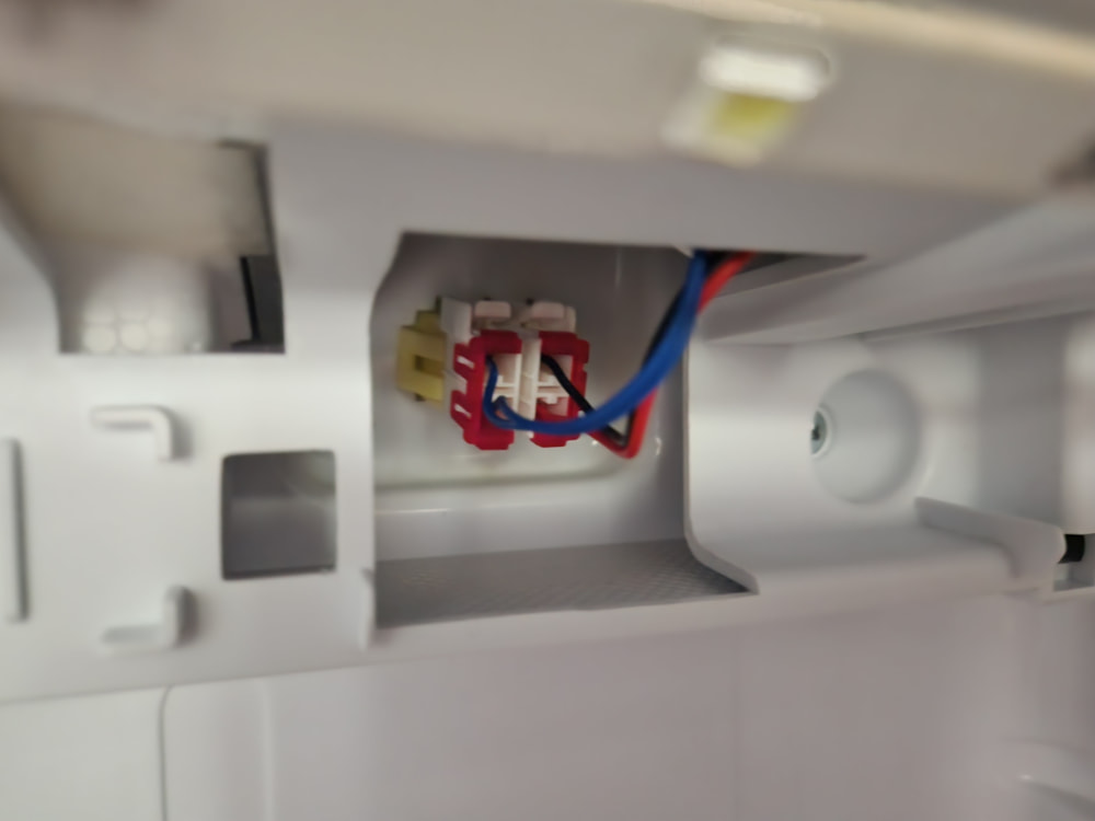

It looks like that thermistor is included in the damper assembly I already replaced. Since there was some improvement, might that be defective and could it be replaced under warranty? Of course it might be the control board too

The red plug runs your LED’s the blue is for the damper motor. The temp sensor is separate but in the same area
I don’t understand. In the assembly there are 2 plugs, one with red and black wires and one with blue and blue wires. There wasn’t anything else plugged into that housing when I removed the original. I can remove the light cover and take a photo of that housing if it would help
sure I appreciate any help understanding your issue
After further review what you have there is the air damper cover not the actual air damper the blue wires are the thermostat (thermistor) we need to determine the part number for the damper
Here’s the image of the wires plugged into the housing. Those wires were part of the assembly cover damper part I ordered and received. The Samsung part is DA97-0806A.
Here’s an image of the old one that had been replaced. Based on videos I have seen, I am under the impression the thermistor is one of these wires. If that is not true, let me know and I’ll go down the path of testing the current one’s resistance. but would need help in how to get at it.
Yes the thermistor is the blue connector the LED’s are the read and black. The part number for the actual air damper assembly is ( Samsung DA97-08318B Refrigerator Air Damper Assembly | Genuine OEM Part )
When I click your link that is not what I ordered. That part looks like what I saw to the left side of the fridge compartment after I removed the cover assembly. I saw people on youtube replacing that part on very different samsung refrigerators but did not see that part in the wiring diagram on APP website for the refrigerator view.
Is that the thing to change then?
The next question is, I know you recommendation is educated, but even after replacing this, what are the odds the issue will not be fixed? Trying to decide on repair vs replace
Yes that’s the actual air damper motor assembly what you changed was the cover assembly that houses the thermistor and LED lights. you probably so some improvement because you jostled the air damper while removing the cover
I got with our local appliance repair guy and see what happened. He sent me the Samsung part number for the assembly cover saying that’s what Samsung told him. He is saying now he was sending the part number for the air damper cover. So, spend another $200 on the right part. Darn it, bad luck. Thanks for the attention and help, would not have figured it out without ya!

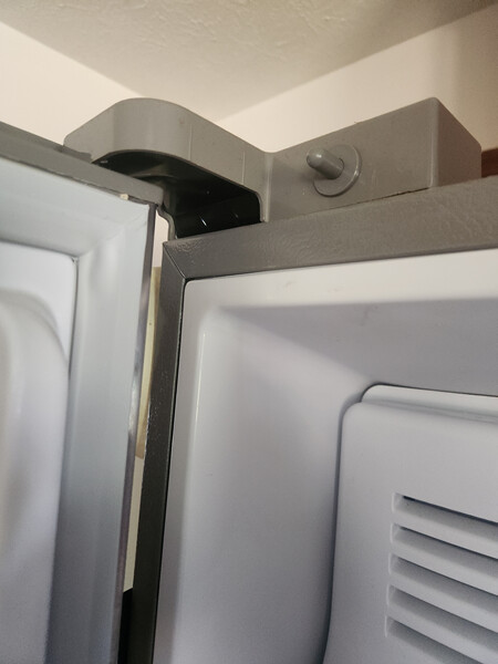

After I wiped the water from the floor, I waited thinking maybe the door wasn’t closed all the way. So I open the door and press on what I believe is the door switch in the photo. Oddly the light didn’t go off. I checked around the door frame to see if there was another switch and did not find one.
I opened the fridge and could not locate a similar button switch.
I did hold the freezer door open and pressed the door switch button for more than 55 seconds. I heard no fan come on. But I should take all the food out for a better test.
Since the light didn’t turn off, I thought it was worth mentioning.
There is water on the floor of course. When I had the door open, I held the switch pictured below and the door-open warning chime rang
