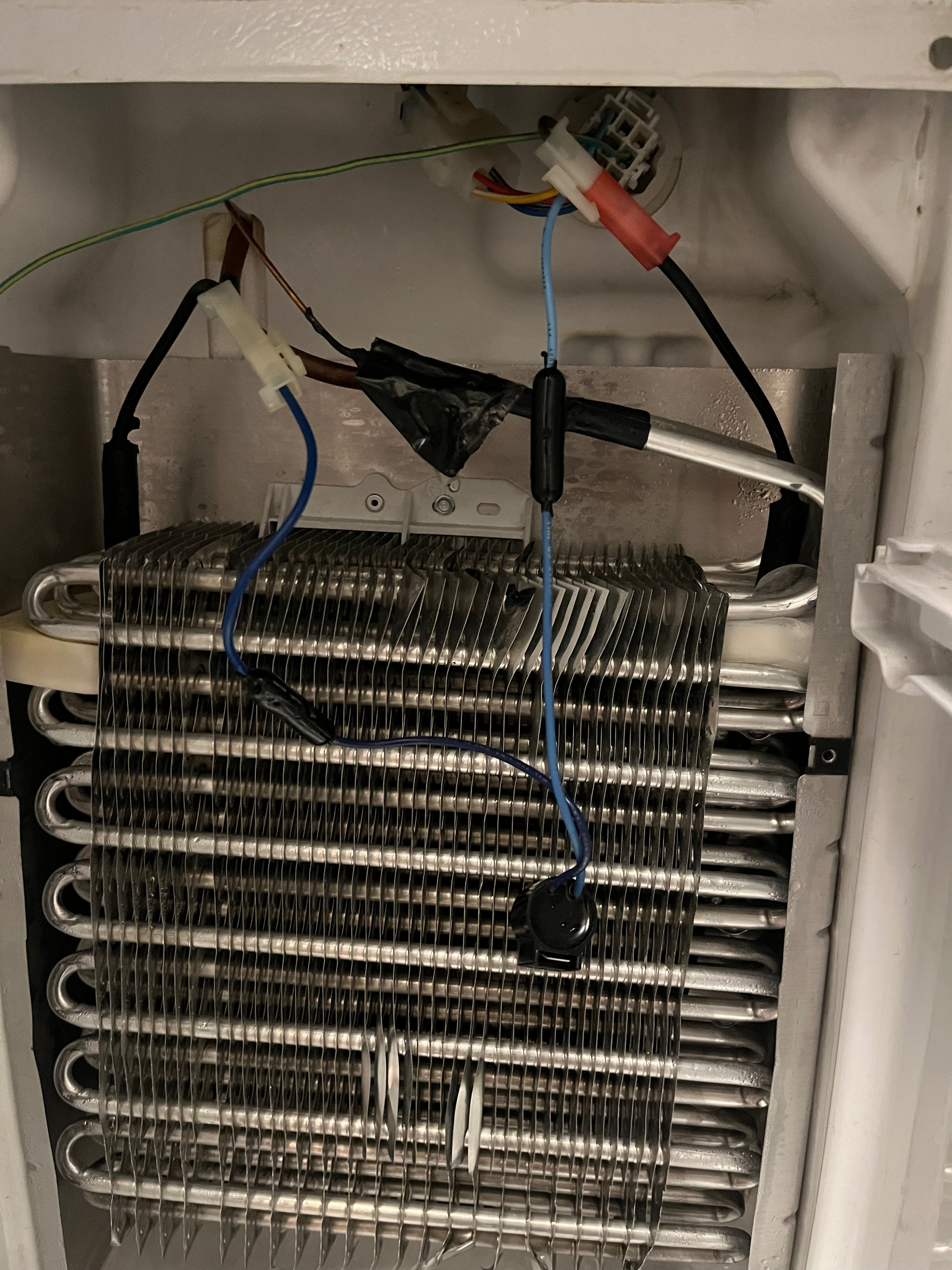

Replace thermostat freezer got better but fridge side still freezing food I can see the screen needs to be replace is hard to reed number but I don’t know if some how it got stuck in one temperature don’t know what else I can try
Brand:Frigidaire
**Model Number:**FGHC2331PFAA
Main Symptom:freezer and fridge too cold
What happens & when:suddenly star getting super cold on fridge side and freezer side not defrosting
Error Code (if any): no codes…
Parts or tests already tried:replaced thermostat
With that display AP7017395 being hard to see, I’d start there. That display could be dragging on the system and causing electrical interference that’s confusing the main control board or it could just be stuck on a certain temperature. Either way, I’d replace that before digging into anything else, there’s a good chance this will resolve the cooling issues.

So if I replace the ” screen” and doesn’t work properly sounds like the main board is next thanks for your advice I really appreciate it…
Not necessarily. With the display being the way it is, it needs to be replaced, and that very well may resolve the issue. If it didn’t, you could have a temp sensor that isn’t reading correctly in the freezer. That would be the next place to look. You can actually go ahead and check that temp sensor as long as you have a meter, if you’d like. Take that thermistor AP7243155 out, should be in the ice bucket and auger area, place it in a glass of ice water for about 5-10 minutes, and check the resistance value. Should be around 27.7kΩ at 32°F.
