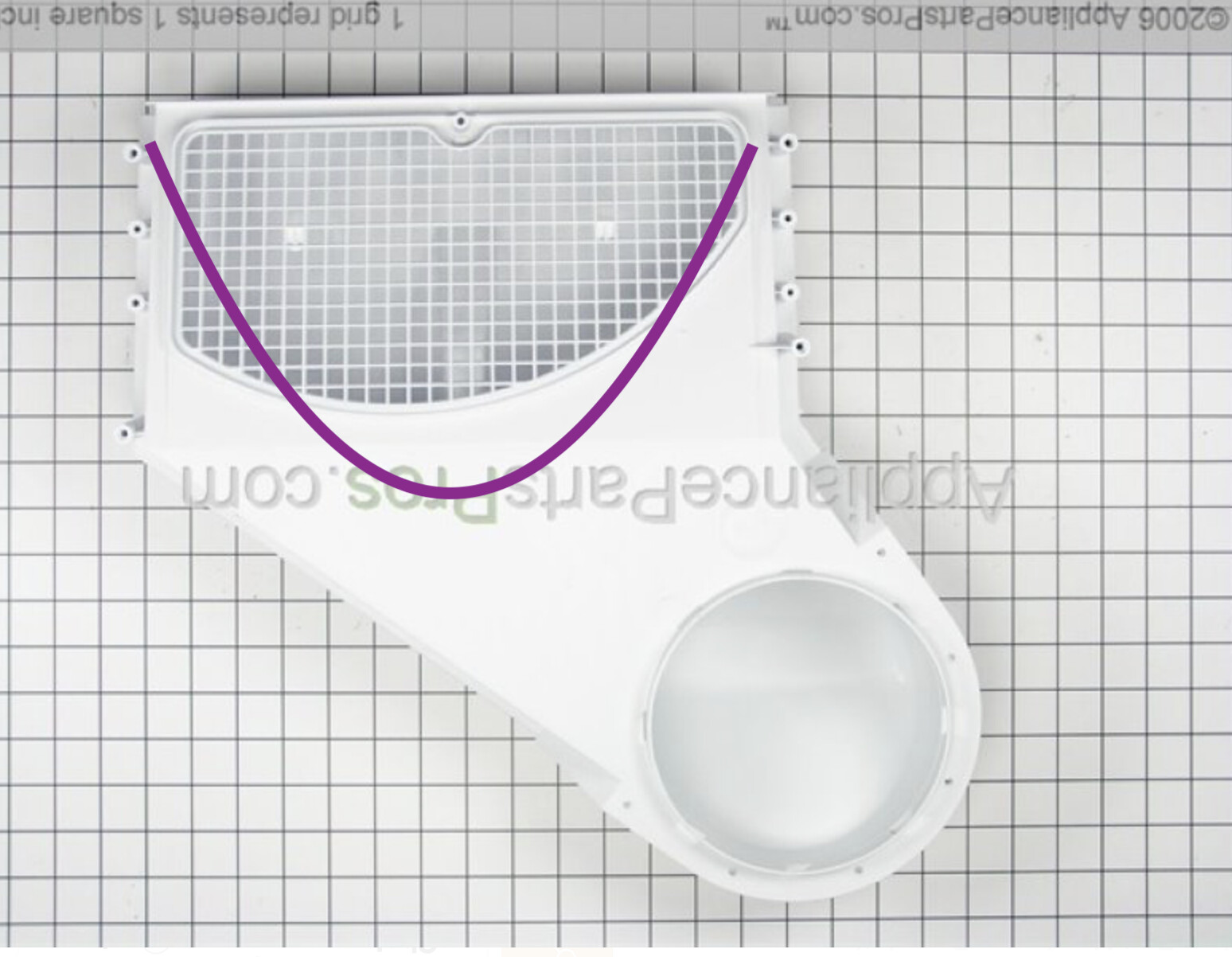

With the vent removed do you fill air coming out of the 4 inch exhaust.Some of these per serial # would have a blower wheel that would strip or go out of round on the motor shaft and the air would not come out!
The blower housing may need to be inspected. If you have the dryer running and check the air coming out of the back of the dryer, is it a good strong air flow or does it feel like a gentle air flow?
Make sure where the lint filter goes like in this screen those holes are all clear of lint!
https://www.appliancepartspros.com/whirlpool-outlet-duct-assembly-wp33001799-ap6007946.html

The problem was that even after 2 hours in the dryer the cloths were still very damp. Now the cloths are 100% dry, but it’s taking an hour and 10-15 minutes (on sensor) for it to finish and that sounds long for a load of cloths (mixed materials) that is not overloaded. The vent is clean, but I will do a more thorough cleaning of the vent and the inside the dryer to see if that helps.
It is possible that the outside vent and it’s cover has a small clog or a bird’s nest or a bee hive is blocking the air flow, however it is on the roof, so I can’t access it myself. So I will use a leaf blower to force strong air through the vent pipe from inside the house hopefully clearing any possible clog.
Also thank bigbuck1, your suggestion about checking the ‘outlet duck assembly” ensuring it’s clean and has no issue, is also a good idea.
However, I first like to see if the above improve the drying time. I have done it about a year and a half ago and to get at it requires more dissembling of the dryer and reassembling is more difficult with lining up the drum, and other stuff. Hopefully it good enough for now and I can do that extra cleaning in a few months when I have more time.
