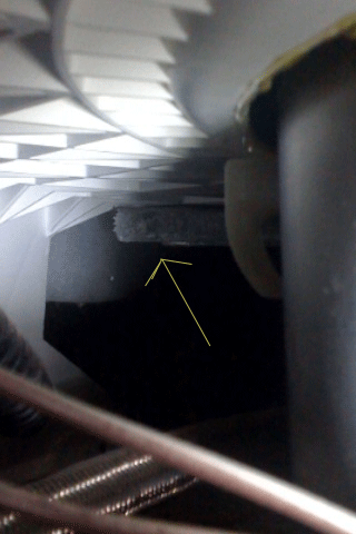

So I have a consistent leak, enough I can’t use (steady drip) that occurs during wash cycle. I’ve checked all the hoses, supplies, etc. they are good.
It’s at the end of a 1 inch wide metal bar right under the washer. It seems like an odd place to leak but I don’t see it anywhere else and don’t think it’s dripping to this spot. included photo. my wife appreciates any hints to help me fix it :smiley:

Could be it is leaking from the main pump to tub seal.
When looking for a leak location a small mirror and flashlight come in handy.
