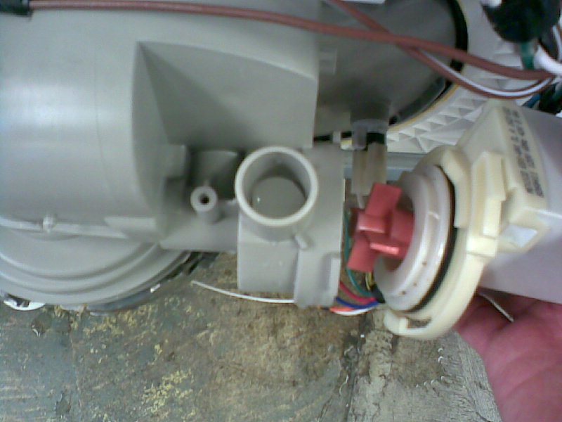

Started making a loud humming sound for about the last month. checked to see if anything was around the food chopper and it was clear. Just wondering if it may be the motor or pump. It gets run about once a day and has continued to work for at least a month , just loud humming noise when running
If you hear the noise during the wash cycle, you will need to replace the pump assembly. The whole unit gets changed together and can be done without removing the DW from the cabinet.
TechnicianBrian
I’ll go ahead and buy the assembly, do you have a link to some install directions? thanks
It isn’t a real hard fix, but can be tricky if you haven’t done them before. Get back to me when you get the pump assembly and I will see what I can find for you.
TechnicianBrian
I have the pump assembly and was wondering if its easier to pull the unit out of the cabinet. I don"t see any way to remove it without moving out. Thanks
[COLOR=#333333]I find it easier for me if I leave it in place, but I have done a ton of these. The sump assembly will be removed from the inside of the tub, so you need to remove the racks, take off the wash arm, and remove the two screws holding the delivery tube to the rear of the tub. The tube can be split in two and separated from the lower part connected to the top of the assembly. The lower part will slide to the right and unlock from the top of the assembly. The wash arm connector will have a clear Mylar ring around it so don’t lose it. From under the tub, remove the drain hose and the drain pump. The pump has a keeper in the upper left corner when you look at it. Press it with your thumb and rotate the pump toward you. It will separate from the sump assembly. Now the assembly is held in place with three white tabs, one directly above the drain hose connection, one 90 degrees to the left, and one 180 degrees in the rear. Just pull them out. Next place your hand under the assembly and push up until it pops out of the tub. The thermister and motor wire harness will still be attached. Remove the motor harness and rotate the thermister counterclockwise to release it from the sump. You should be able to remove the whole thing. Put the new on back in opposite of the way the original came out. Be careful of the while cover over the motor. It must go under the tub and not be pinched in between the sump and the tub. You may need to put some pressure on it to make it seat well since it is new. Connect the motor harness and install the thermister before pressing the pump in place. Put everything back together and that should do it. I had some students do this in class today and took some pictures. Hope they help.[/COLOR]

I went ahead and pulled the unit out. If I had done this two or three times I may attempt it under the cabinet and the worst part was getting it out and putting it back under. Thanks for the photos and your help. The washer is much quieter now, the arms my not be as smooth as when new, but at least its not like a plane getting ready for takeoff out of the kitchen.:slight_smile:

“The pump has a keeper in the upper left corner when you look at it”
Brian, what does the keeper look like that holds the pump in? Os it it part of the pump housing that gets pushed in. I am doing this same repair.
My pump also has a deflector that goes on it somehwere but cannot remember exactly how it goes? Can you help with that? Thanks
paul
Hey Paul,
The keeper is the part of the pump that gets pushed in to remove the pump. If you look at photo #2, my thumb is pressing in the keeper. As for the deflector, it sits above the pump and is held in once the pump is reinstalled. The deflector is missing on my photos because they are hard to get installed properly after service so some techs tend to get rid of them. Hope this helps.
