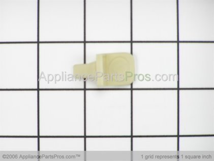

My dishwasher does not have enough pressure to wash, nothing gets clean especially the top rack. I looked and it is missing the valve check on the spray assembly base. Should I replace this valve or replace the entire spray arm assembly? Also, does a new spray arm assembly include the valve? And how do I replace either part?

This is the part it is missing. They call it the check valve? With this valve gone does water run out of the base of the spray arm and reduce pressure?

It is possible and because the part in very inexpensive, it worth to try.
