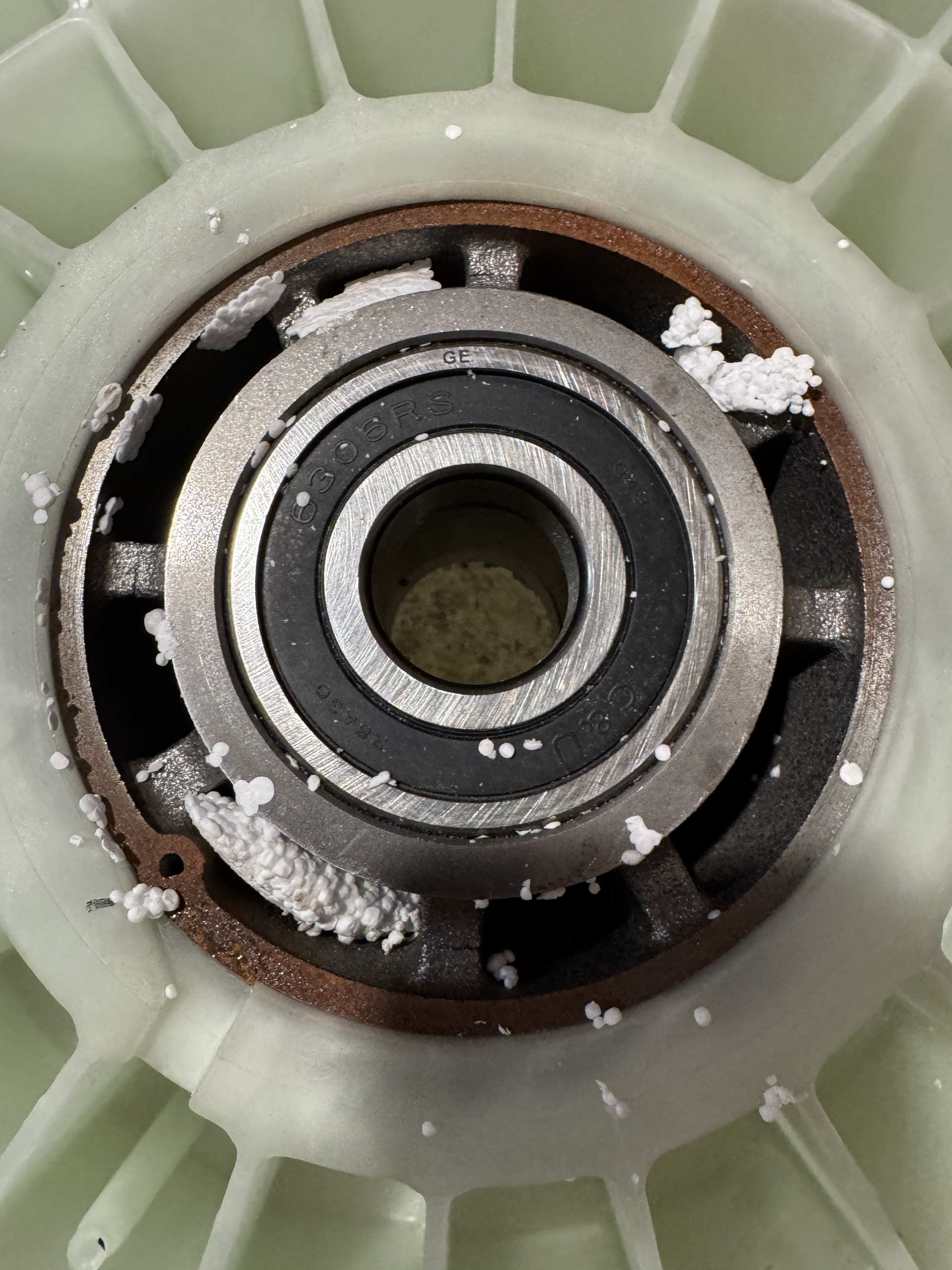

Ordered a new rear tub assembly with bearings. Arrived today. Where the bearing housing is located, there is a loose metal ring, flat but wide, that is bouncing around between the front and rear bearing assembly. I just need to know if this is normal and will line up once the shaft is inserted or if this is broken and i need to order another new tub assembly.
yes when you put the drum shaft thru the bearings the taper of the drum spindle will push the washer against the outer bearing
Thank you. I added a photo link so you could see what it looks like not centered and then I used my fingers to center it. Nit sure how to make that stay while trying to install but that will have to be Friday. Thank you for the replay.
Adding to my question. The first tub arrived and the bearing housing was rusted. Not just surface rust but flaking rust. They sent out a new outer tub. This one is better but there is still some rust. Should this be a concern or can I go ahead and replace this thing. I can’t really wait for another replacement to arrive. But will do what you suggest. Thank you.
While I don’t think that the rust on the outer part is an issue, it still surprises me that it is rusted. As long as there is no rust on the mating surface or faces of the bearings I think you’re ok to install
Thank you for the quick reply.

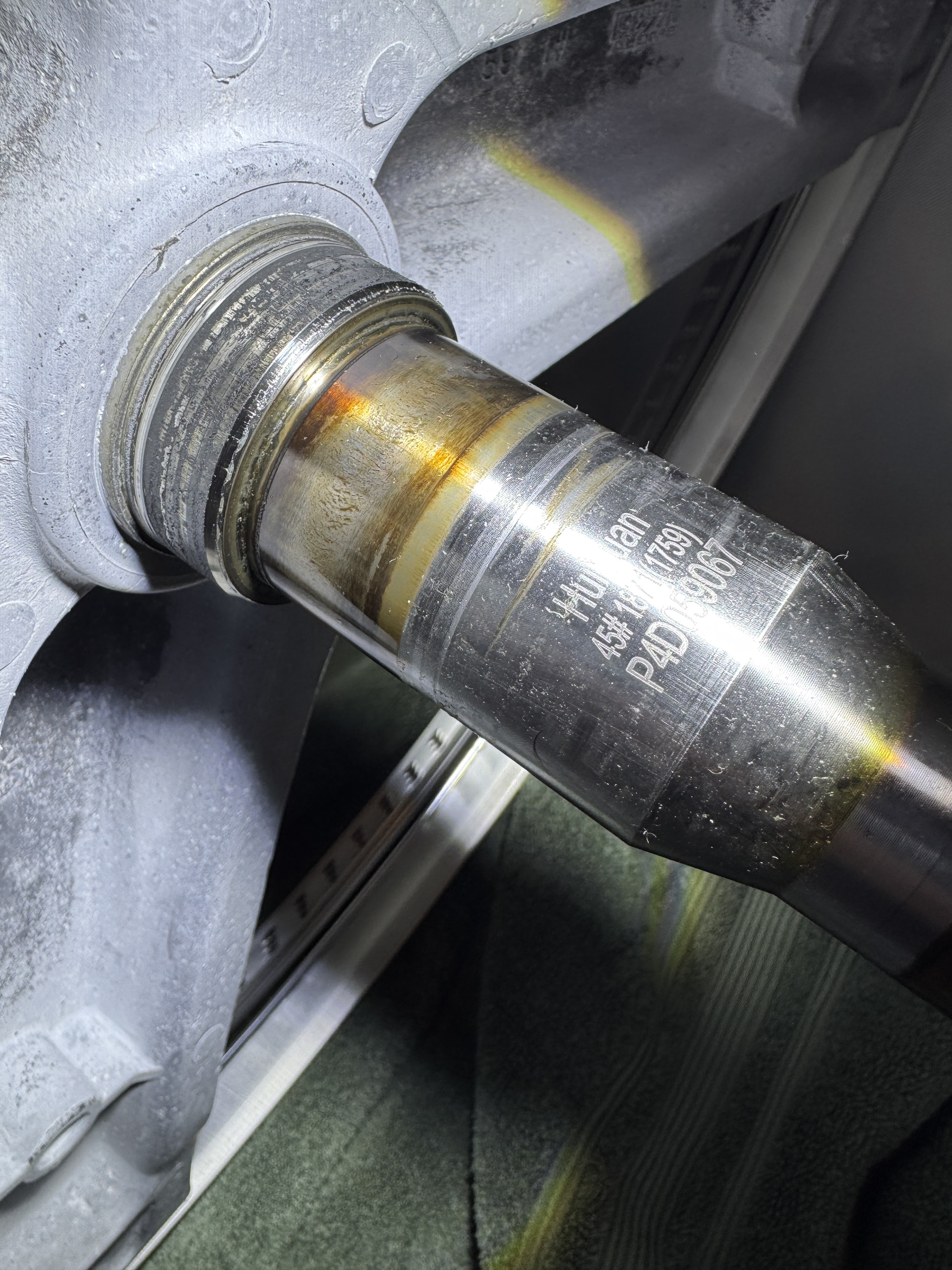

Is there anything I need to do to the shaft before putting this back together? Clean it? Lubrication? And along those lines anything I can be proactive about with the bearing housing to help keep it alive longer than 1-3 years?
Cheers
You can use some emery cloth or fine grit sand paper to polish the shaft smooth and apply a light coat of white lithium grease before assembly. As far as extending the life of the bearing itself, there’s not a lot you can do since everything is pre assembled and sealed
