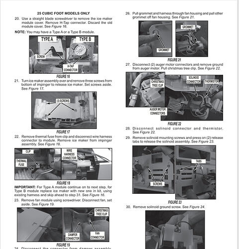

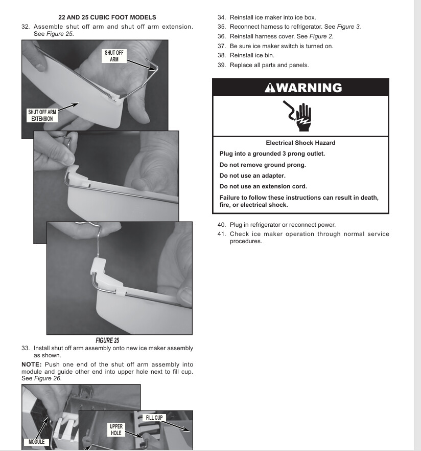

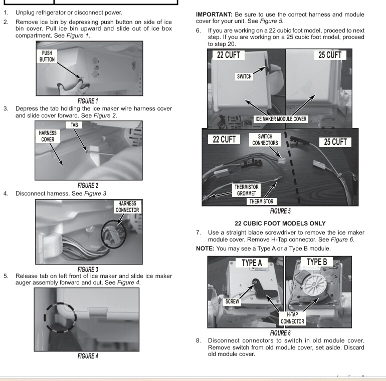

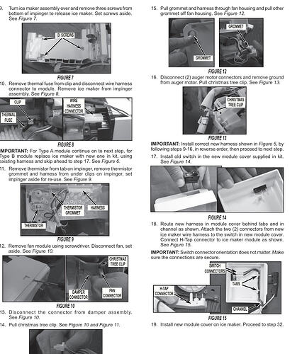

Hi tomboy4jesus,

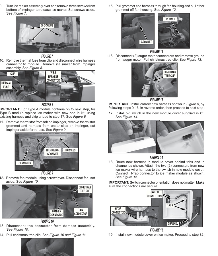

It’s possible that the part is defective. I sent you the tech sheet, and hopefully that will help. It’s really odd that it’s still reading 0.
After you go through the tech sheet, let me know if it’s still not working. If it isn’t, we can keep troubleshooting and try to get it working for you.
this tech sheet does not match my ice maker. there is no button on the side to take the cover off. there is no “on/off” switch and there is no H-tap connector piece. I can’t follow these instructions.
