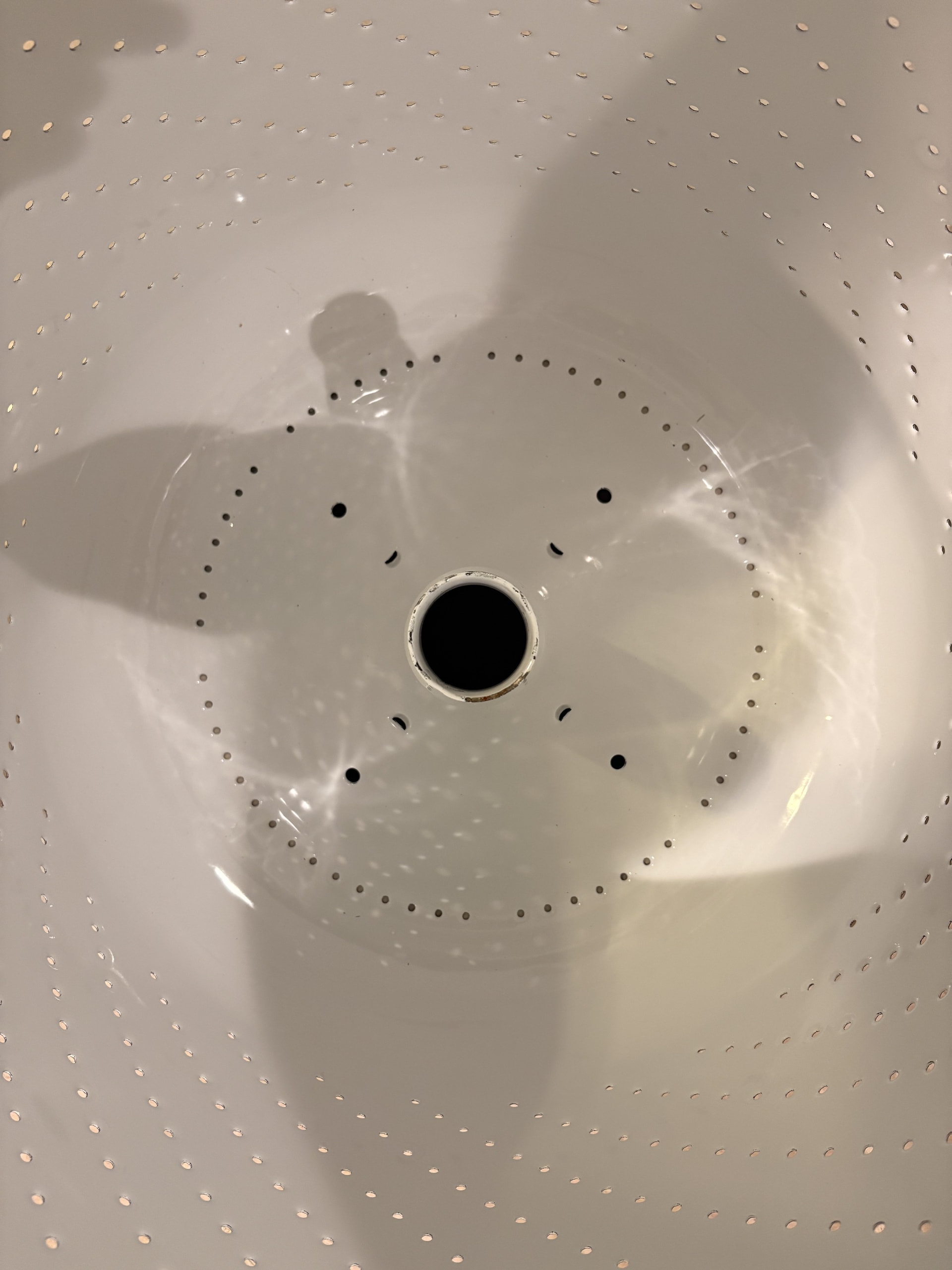

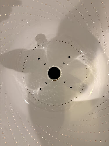

My new inner tub replacement looks different than the original I'm replacing
Brand: Kenmore Series 80
Model Number:110.22872100
Main Symptom:Inner Tub replacement
What happens & when: The old original tub has 2 larger holes for the lint collectors but the new tub does not. It just has 4 holes and these 4 tiny slits. Are you sure this is the correct replacement? Thanks.
Error Code (if any):no
Parts or tests already tried:I received a new inner tub from APP.com

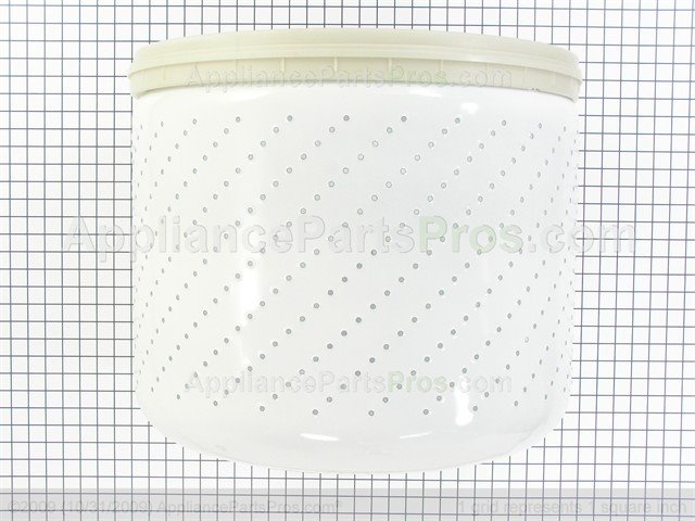

According to the manufacturer the correct replacement inner tub is W10389328, the manufacturer has redesigned the inner tub.
Great, I’ll go ahead and replace the old one, it’s rusted on the inside/center.
I guess I’ll call-in because the Balance Ring was damaged in shipping. One of the tabs was broken and it leaks a little water from the fill plug.
Definitely, if you received a damaged part go ahead and reach out to our customer service team at 1-877-477-7278.
Will the old Balance Ring work? That is if I can R&R without damaging it.
It might but I cannot 100% confirm that. From all appearances the manufacturer only redesigned the bottom of the tub, but they usually aren’t very forthcoming on what all has been changed when they do a redesign.
