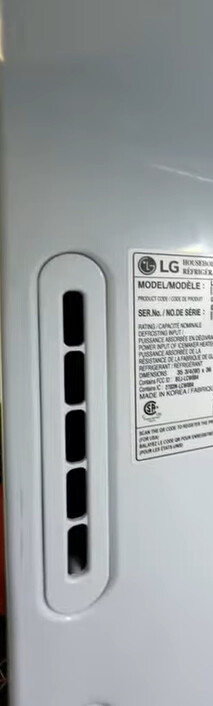

Hi justme0987, it sounds like you’re having a temperature issue. Have you tried placing a thermometer in the freezer to check the actual temperature? There is a vent that runs into the ice bucket compartment to help keep the ice cold. You’ll also want to check whether the freezer section is frosting up, as excessive frost can restrict airflow and cause cooling problems.
Is this vent part of the icemaker unit? I am thinking of replacing the icemaker with a new one?
If it comes with the vent this should solve the problem if not then I need to buy a new vent.

I hope you can find the videos helpful to explain the problem . If you need more info or pictures let meknow. The fan that has this part number may need to be replaced
Part Number: EAU63923601
the part number that I ordered in EAU63923601
Hi justme0987, your freezer needs to be set to 0°F. Also, the fan I’m referring to is the one that helps keep your ice cold. I attached a picture of the vents that circulate the air through the freezer to keep the ice frozen.
