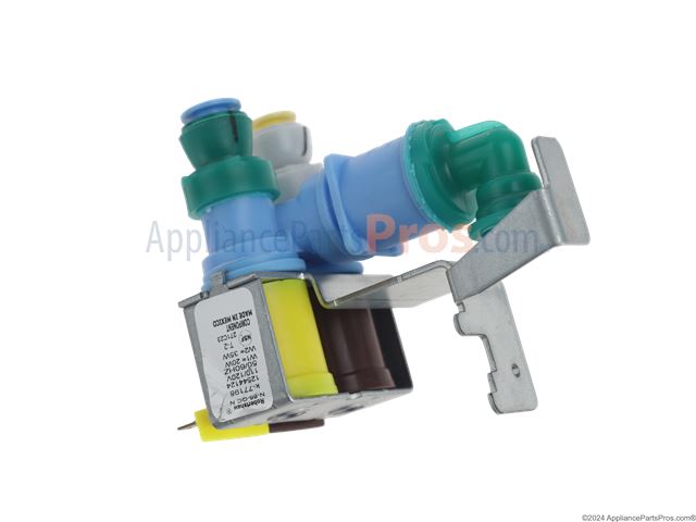

That’s usually going to be the icemaker, the valve, or a blockage between them. I would test the valve and check that the lines between the valve and the icemaker are clear first.
On this one you can actually test the valve really easily compared to come. Unplug the fridge. Go to the valve in the back and look for the wire connectors. The dispenser valve should have a yellow wire with white tracer and a white wire, while the icemaker valve should have tan and white wires, the dispenser connector should fit on the icemaker valve terminals but the icemaker connector will not fit on the dispenser terminals, but you only need to connect the dispenser connector to the icemaker valve. Then you can plug the fridge in, go back to the front, and call for water at the dispenser for about 7 to 10 seconds, then check if there is water in the icemaker tray. If not, and the lines are clear, then the valve is bad. If there is water in the icemaker tray then the icemaker isn’t calling for water and needs to be replaced. Oh, and don’t forget to correct those connections at the valve if it ends up being the icemaker, I’ve seen that happen before.
