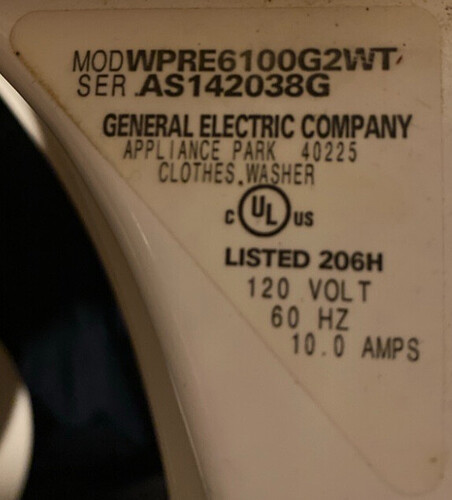

My GE WPRE6100G2WT clothes washer won't agitate or spin
Brand: GE
Model Number: WPRE6100G2WT
Main Symptom: doesn’t agitate or spin
What happens & when: all the time, the motor never engages as of earlier this week

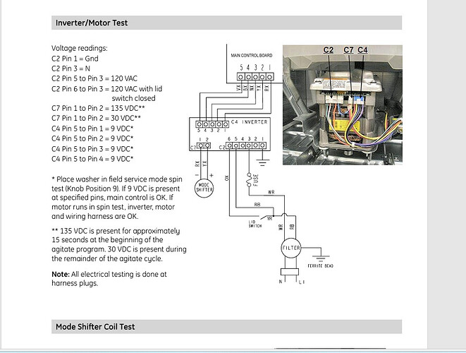

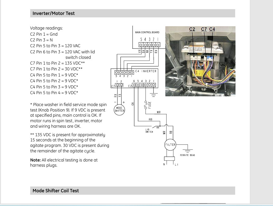

Next, I tested voltages guided by page 39 of the Technical Service Guide (https://forum.appliancepartspros.com/uploads/short-url/sHgpik25jeg27wN4zDMAyUIMmj3.pdf). I repeated each test multiple times to make sure I got consistent results:
  • C2 pin 5 to pin 3 = 118 VAC
  • C2 pin 6 to pin 3 = 118 VAC with lid switch closed
  • C7 pin 1 to pin 2 = 298 VDC during first 15 seconds when in position 6 (AL) of field service mode test
  • C7 pin 1 to pin 2 = 298 VDC after first 15 seconds when in position 6 (AL) of field service mode test
  • C4 pin 5 to pin 1 = 8.9 VDC when in field service mode position 9 (S)
  • C4 pin 5 to pin 2 = 8.9 VDC when in field service mode position 9 (S)
  • C4 pin 5 to pin 3 = 8.9 VDC when in field service mode position 9 (S)
  • C4 pin 5 to pin 4 = 8.9 VDC when in field service mode position 9 (S)

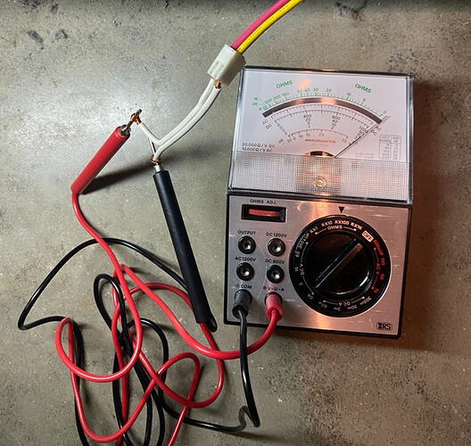

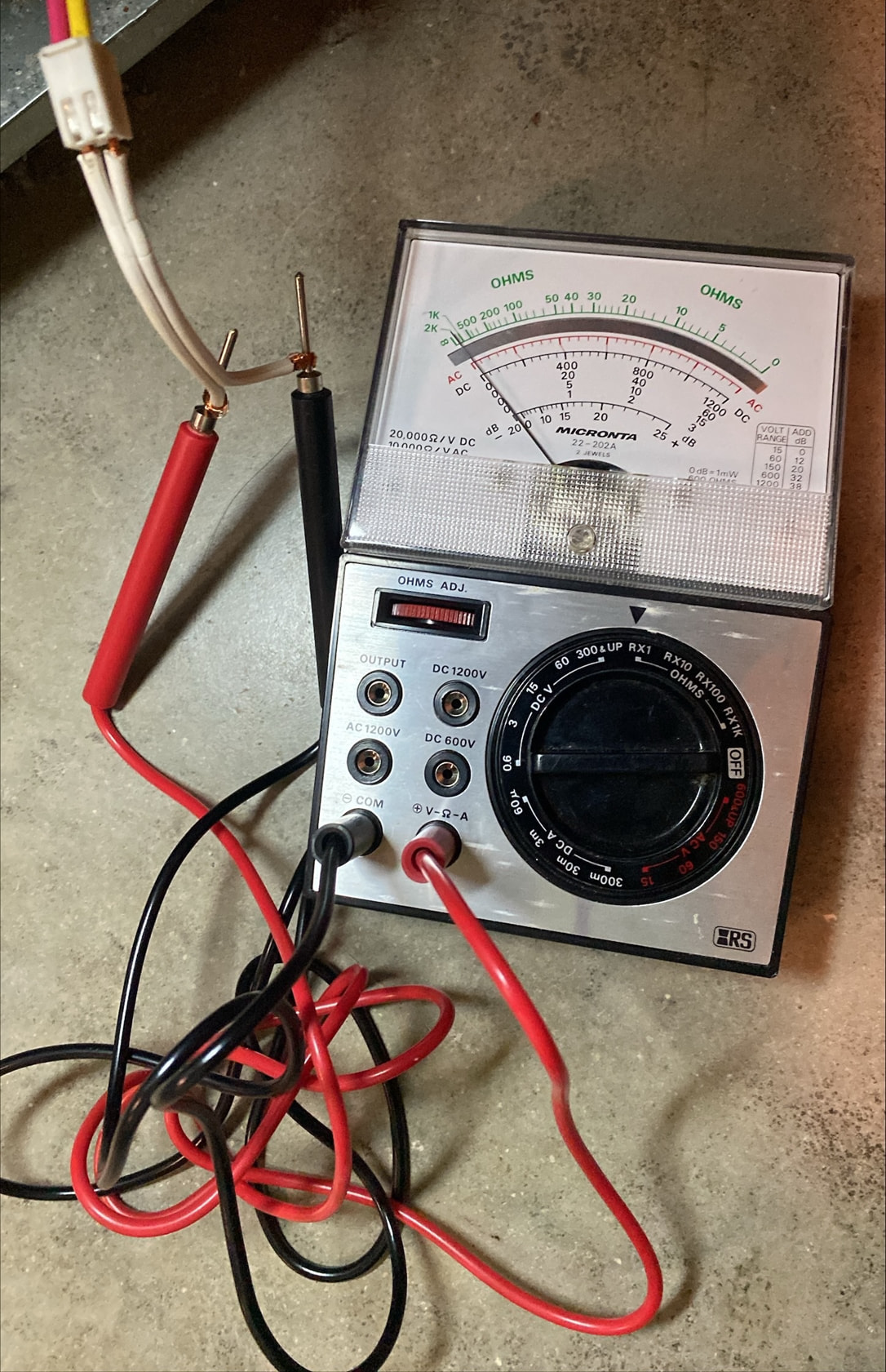

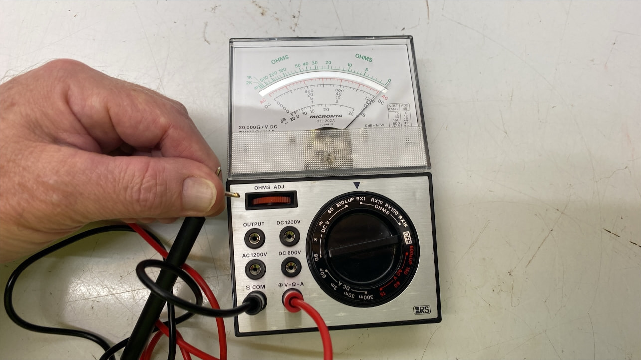

Thank you so much. Here you go. I’m including photos so you can verify that I’m doing this correctly. I unplugged the connector at that motor which runs to the mode-shifter and I tested resistance between the 2 wires that run to the mode-shifter. I had to use a short lead-wire because my probes don’t fit inside the connector. I used 2 different multimeters for comparison.
In this first photo, I used my simpler but newer digital multimeter which I had used in my previous tests. It only has one Ohms setting (K Ohm). When I hook up the probes, the zeros are on solid but the “1” to the left of the three “000” is flashing. I’m not exactly certain what that means.
Next, I used my older analog multimeter for the same test. I think I’m supposed to set it at R100 since I want to measure something around 100 Ohms. On this multimeter, when the probes are not connected, the needle is all the way to the left. When the probes are touched together to zero the meter, I adjusted the needle to line up exactly at zero. As shown in the photo below, when the probes are connected to the mode-shifter wires, the needle ends up slightly to the right of zero.
I assume this means there is ZERO resistance and we have a bad mode-shifter?
Yes — you’re testing the correct two wires, but there’s an important issue with how the meter readings are being interpreted.
On the digital meter, the flashing “1” at the far left generally means over-range/open circuit, not 1,000 Ω. So that meter appears to be telling us there is no continuity through the mode-shifter coil.
On the analog meter, R×100 is not the right range for checking a roughly 98 Ω coil. On an analog meter the setting is a multiplier, so R×100 means you multiply the scale reading by 100. That makes it difficult to accurately measure something around 100 Ω. If that meter has an R×1 setting, use that instead.
One more test
Unplug the washer and leave that connector disconnected exactly as you have it.
Set the analog meter to R×1. Touch the probes together and use the OHMS ADJ knob to put the needle exactly at 0 Ω on the far right. Then put the probes across those same two mode-shifter wires.
For a good mode-shifter coil, we’re looking for approximately 98 Ω.
If the analog meter stays toward the left/open side, and your digital meter continues displaying the flashing 1, then the two meters are agreeing: the mode-shifter coil is open.
One other thing caught my attention in your analog-meter photo: the needle appears fairly close to the zero-ohm end of the scale. Because you’re using R×100, that doesn’t necessarily mean the circuit is open. That’s why I don’t want to condemn the shifter based on these pictures alone.
Try R×1 and tell me where the needle lands on the OHMS scale—or send another photo. At that point we should be able to make the call without replacing parts unnecessarily.

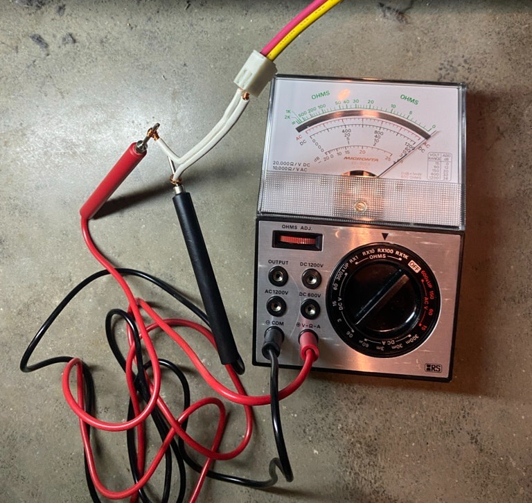

Ok, thank you for all that explanation. I redid my tests with just the analog multimeter since there’s nothing to change on the digital one.
I first calibrated the needle to zero with the dial set to RX1. In the photo it seems to have drifted slightly to the right, but it was on zero when I calibrated it right before snapping the photo.
Then I hooked it up and the needle didn’t budge. It remained right all the way to the left as though I hadn’t connected anything. I even touched the probes together just to make sure I hadn’t goofed something up and the needle jumped right back over to the right and as soon as I would separate the probes with just them connected to the wires, then it would return right back over to the left as if nothing was connected.
Yes — that test result is much more conclusive.
Since you verified the analog meter is working by touching the probes together, but the needle stays all the way to the left when connected to the two mode-shifter wires, the meter is reading infinite resistance/open circuit.
On the GE WPRE6100G2WT, that means the mode-shifter coil is open. A good coil should give you a measurable resistance; it should not behave exactly like the probes are disconnected.
So based on this test:
Meter probes together → needle goes to 0 Ω: meter and leads are good.
Across the two mode-shifter wires → needle stays at ∞: mode-shifter coil is open.
Conclusion → the mode shifter is bad.
You don’t need to worry about the tiny amount the zero adjustment drifted in the photo. That would matter if we were trying to distinguish, say, 90 Ω from 100 Ω. It doesn’t matter here because you’re getting no movement whatsoever.
At this point, I would replace the mode shifter/shaft-and-tube assembly(GE WH38X10017 Washer Mode Shifter & Shaft Assembly | Genuine OEM Part) rather than the control board. This also fits very well with the shifting/agitation problem we’ve been chasing.

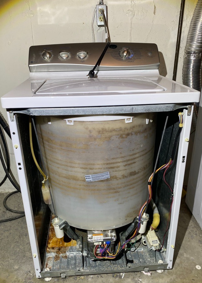

Ok, based on our troubleshooting above, I gambled and purchased a mode shifter/shaft-and-tube assembly (GE WH38X10017). It took me a lot longer than I’d anticipated to perform the surgery, but I managed the entire replacement job without too much fanfare. Unfortunately, even with a brand new mode shifter now in my washer, I am back in the same place I was before with ALL the same test results and 4-blink light pattern on the motor. I’ve reset the motor to where it flashes normally, but then as soon as I try to engage any spin or agitate activity, the light switches back to the 4-flash pattern pointing AGAIN to a bad mode shifter.
I measured the resistance on my new mode shifter and it measures 69 Ohms with a brand new digital multimeter I just purchased. I realize that in previous postings above it was indicated that this test should measure 98 Ohms ± 10%, but I asked another technician I know and out of curiosity he tested a couple other brand new OEM mode shifters he had in stock (also WH38X10017) and they all tested at 69 Ohms. So I don’t know if I’m caught in some kind of warp in the time-space continuum, or maybe 69 Ohms is simply the new normal?
Anyway, I’ve done more research on the internet and am being informed that if I’ve replaced the mode shifter with a brand new one and the motor is still complaining that the mode shifter is bad, then something is either wrong with the connection between the motor assembly and the mode shifter or the motor’s controller board has lost it’s mind and the motor assembly needs to be replaced. Unfortunately, I can’t justify spending ANOTHER $350 to repair a 20 y/o washer that probably isn’t even worth that much.
Any other ideas of things for me to try before I give up?

The C7 1 & 2 test pin locations for the mode shifter 135v AC for 15 seconds then 35v AC
Sorry DC voltage for the pin out tests

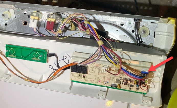

Jeffrey, I recognized that latest table you posted so I reread my notes above and it looks like I DID do that test before, though it wasn’t very precise since I was just trying to keep the probes touched to the posts on the connector on the motor. But this time (see photo below) I got a bit more sophisticated and more solidly connected. I hooked up the original mode shifter and put safety pins through the wires that I could attach my probes to. As soon as I plugged the washer into the wall, immediately it measured 290 volts. You’ll see in the photo that I had the polarity backwards, but for this purpose it doesn’t matter… just subtract the minus sign. Then I put the washer into field test mode and moved through the various positions to AL and AH. The measured voltage never changed except by maybe momentarily by a volt or two one way or the other as test positions changed. It never dropped to 135 VDC or 30 VDC, even after 60sec. The only time the voltage dropped was when I unplugged the washer from the wall. It acted like there’s a capacitor in there somewhere. The voltage dropped gradually from 290 VDC down to 0 VDC over the course of probably 2-3min, beginning rapidly and then slowing down the closer it got to 0 VDC. I don’t know if these results are expected. I’m just reporting.
It really sounds as if there is an issue with the motor control. Yor extremely high voltage reading and no change in voltage during mode changes are the biggest indicators
Is it possible to replace only the motor control? or would the only option at this point be to replace the entire $350 motor assembly?
The GE WH20X10058 is not sold as a separate, standalone inverter board. It is manufactured and sold strictly as an integrated drive motor and electronic inverter assembly
Thank you Jeffrey. Then I guess I’m at the end of the line and it’s time to buy a new washer. Thanks again for all your help with this project! I totally appreciate it!
