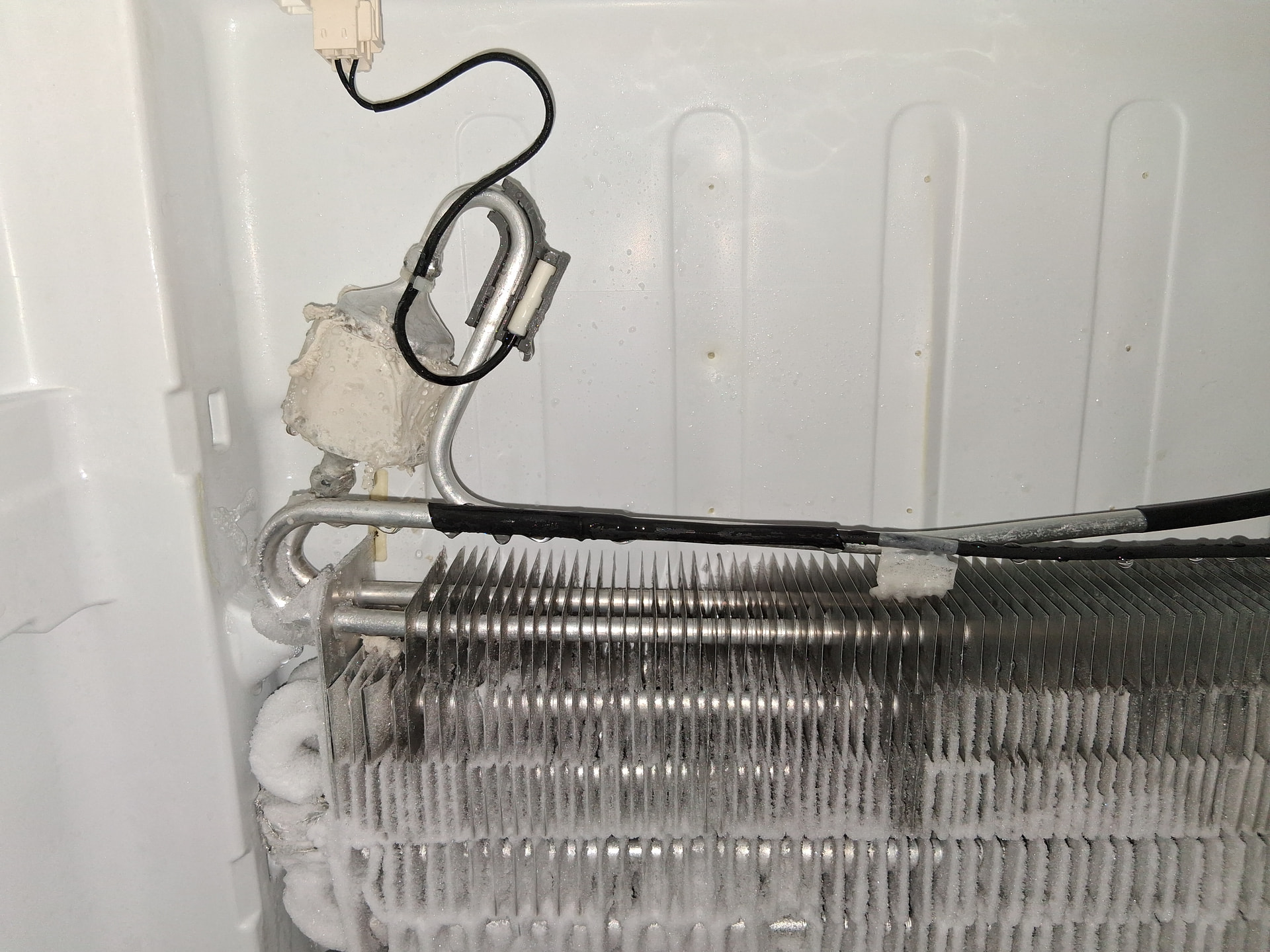

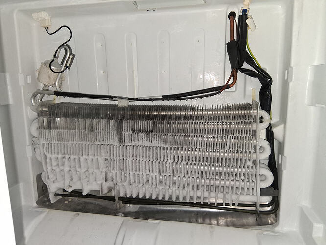

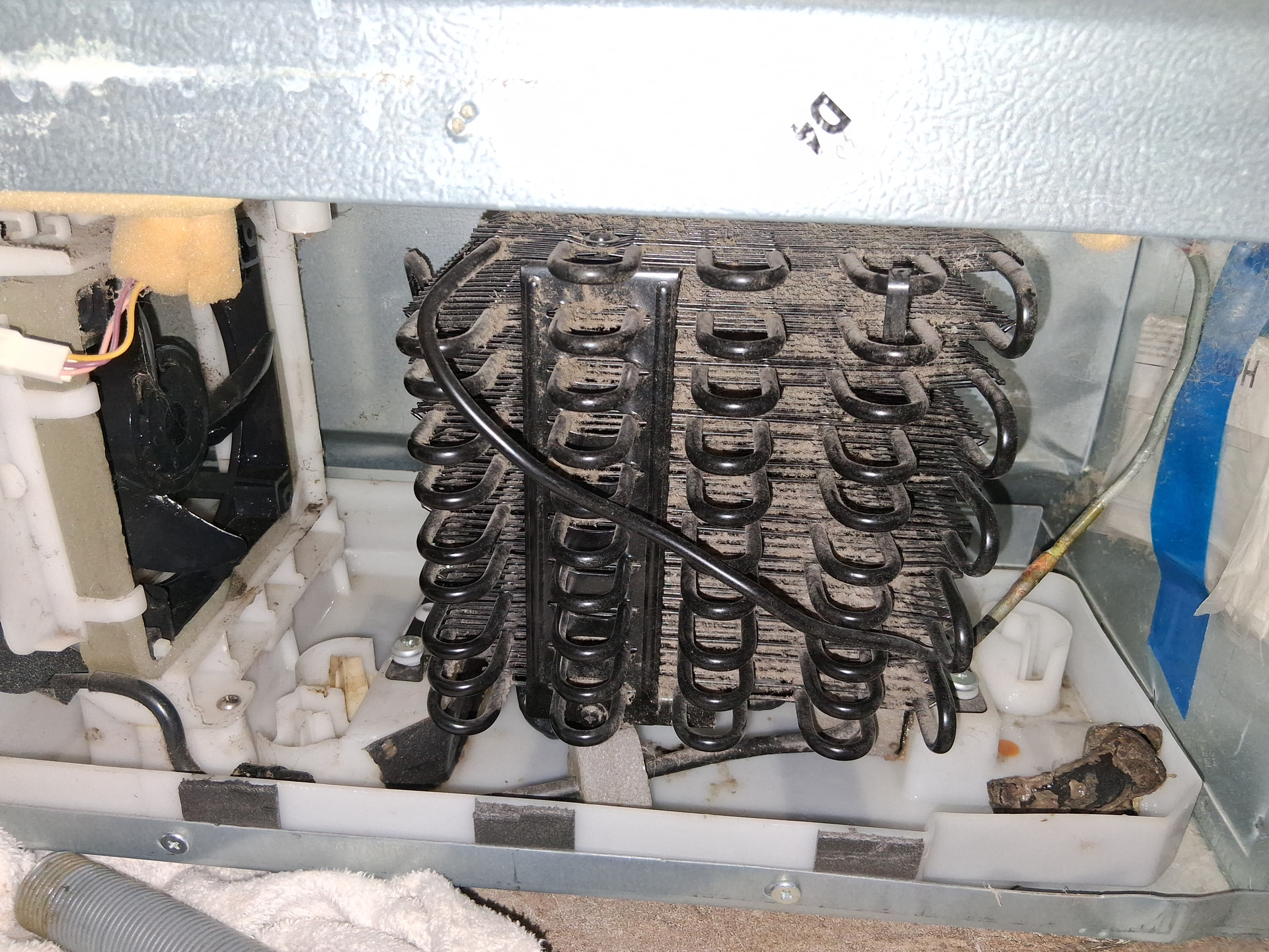

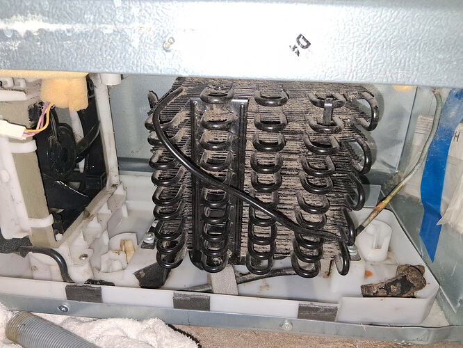

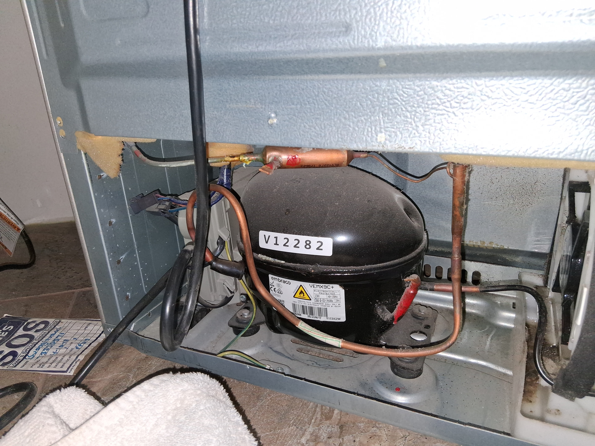

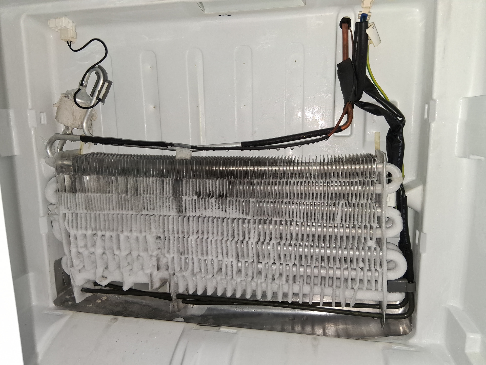

Hi Jeffrey, I wanted to update you on how I made out with my situation with the ice build up on my haier. Yesterday I followed all of the steps you provided me, and it went pretty smooth. I sucked everything up with a shop vac and took a flexible pipe brush and cleared out the whole drain. After that I didn’t put everything back in case it happened again. Unfortunately when I woke up to check everything, there’s a little condensation in the fridge and some ice on the bottom of the freezer. I guess I will have to take some additional steps you’ve mentioned about the drain strap, etc.
Here are some pictures. thank you
Judging by your pictures, I don’t think the drain is the problem. If that last picture was taken after only 24 hours of operation, then the most likely causes are one of these two issues:
  1. A failed defrost component – either the defrost heater (element) or the defrost thermostat isn’t allowing the evaporator to defrost properly, causing frost to build up and restrict airflow.
  2. A sealed system issue – if the frost pattern is only covering part of the evaporator, the refrigerator may be low on refrigerant or have another sealed system problem
