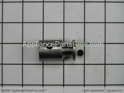

[FONT=Arial]The impeller attached to the motor [/FONT]FONT=Arial is now rubbing on the steel cover in the front lower lefthand corner of the dryer.The motor seems to be ok, but the shaft has about 1/4 inch of play from front to back. Would the motor have to be replaced?[/FONT]

I’m afraid I did not get you right. When you said “impeller”, which part did you mean:
[CENTER]The motor pulley[/CENTER]
[CENTER]or[/CENTER]
[CENTER]The blower wheel[/CENTER]
[/CENTER]
[LEFT]If we are talking about the motor pulley, it has a screw which could be tighten.
If we are talking about the blower wheel - it also has a screw which could be tighten and if it would not help then it has to be replaced.
The motor shaft should not play and if it does - the motor has to be replaced.
The part number for the motor (including the motor pulley) is [COLOR=#0066cc]AP2043550[/COLOR]
The part number for the blower wheel is [COLOR=#800080]AP2043548[/COLOR]
