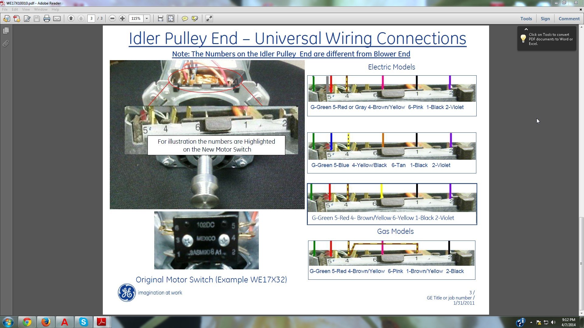

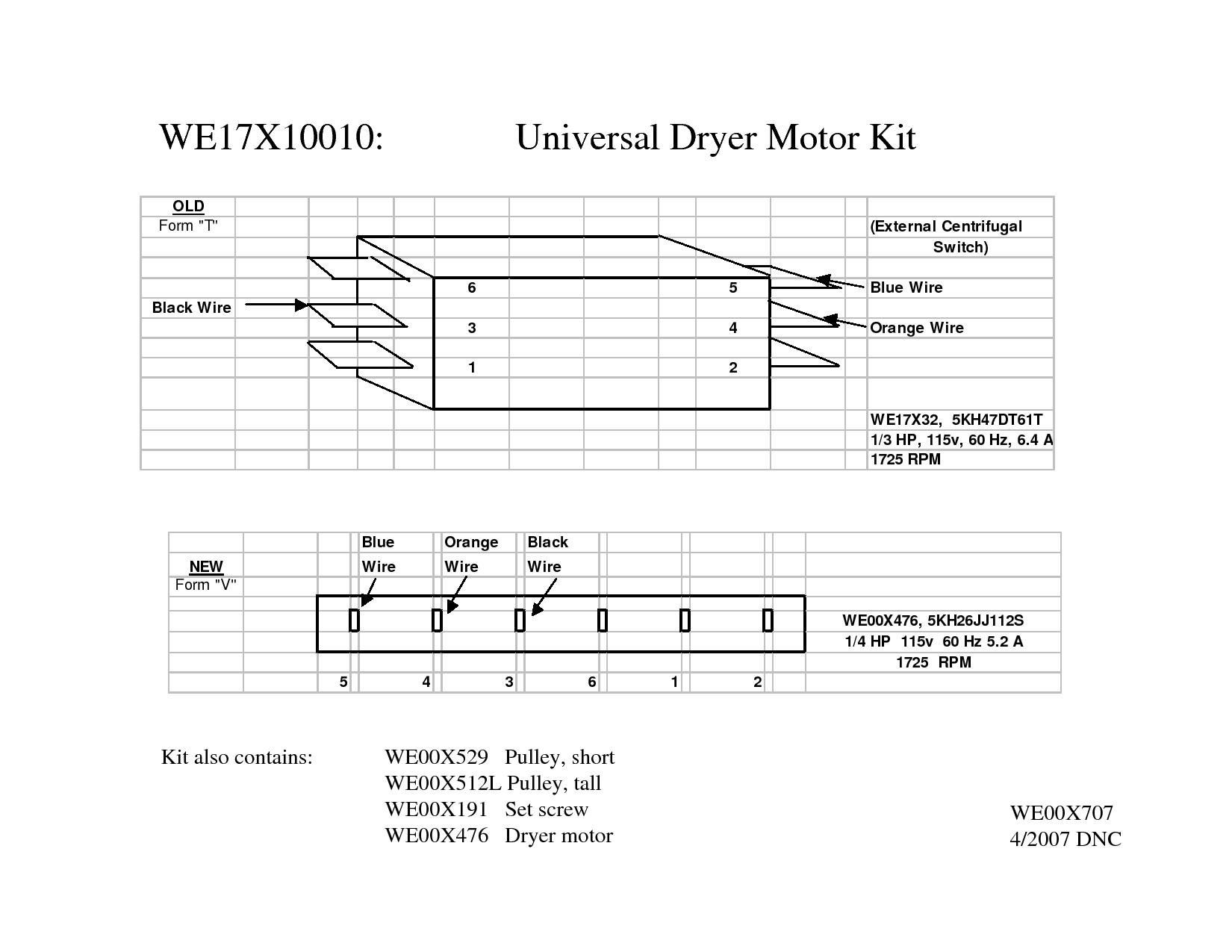

I found this on the internet. How many wires does the old motor have?
I also found this.
