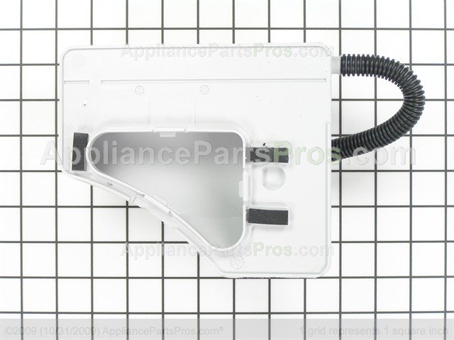

Maytag MVWB850YG1 Leaking from back and front
Brand: Maytag
Model Number: MVWB850YG1
Main Symptom: Leaking from back and front
What happens & when: When I run a cycle in the washing machine it’s leaking from somewhere, but I can’t tell. It does seem to be leaking in the back of the washing machine and in the front of the washing machine. I did notice when it’s filling with water in the the soap reservoir, the water is coming in so fast, it’s going up over the top of them. I don’t believe this is the sole leak because I turned the pressure down at the valve. I’m not sure what where I can check for the leak. Any ideas and thank you for your time
There was actually a service pointer for this exact issue. I’ve attached that below. You’ll need to replace the dispenser cup with part # WPW10187307 which has been redesigned to take care of this.
