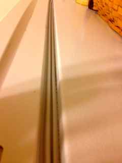

What is the part number of the new door gasket?
Can you take a pictures of the door and gaps and post it on the forum please?
Part number (from the invoice)
AP4073216 (63001612) Seal, frz. door (wht)
Picture entitled gasket1 shows before lower fridge door is opened then closed (minor gap in center)
Gasket2 shows big gap after door is opened.
Hi.
Looks like the door may need an adjustment. Loosen up top hinge screws and raise the opposite end (where the handle is).
Tight screws back.
Also see if you can raise the front legs.
Simon.
will do and will report back when complete
