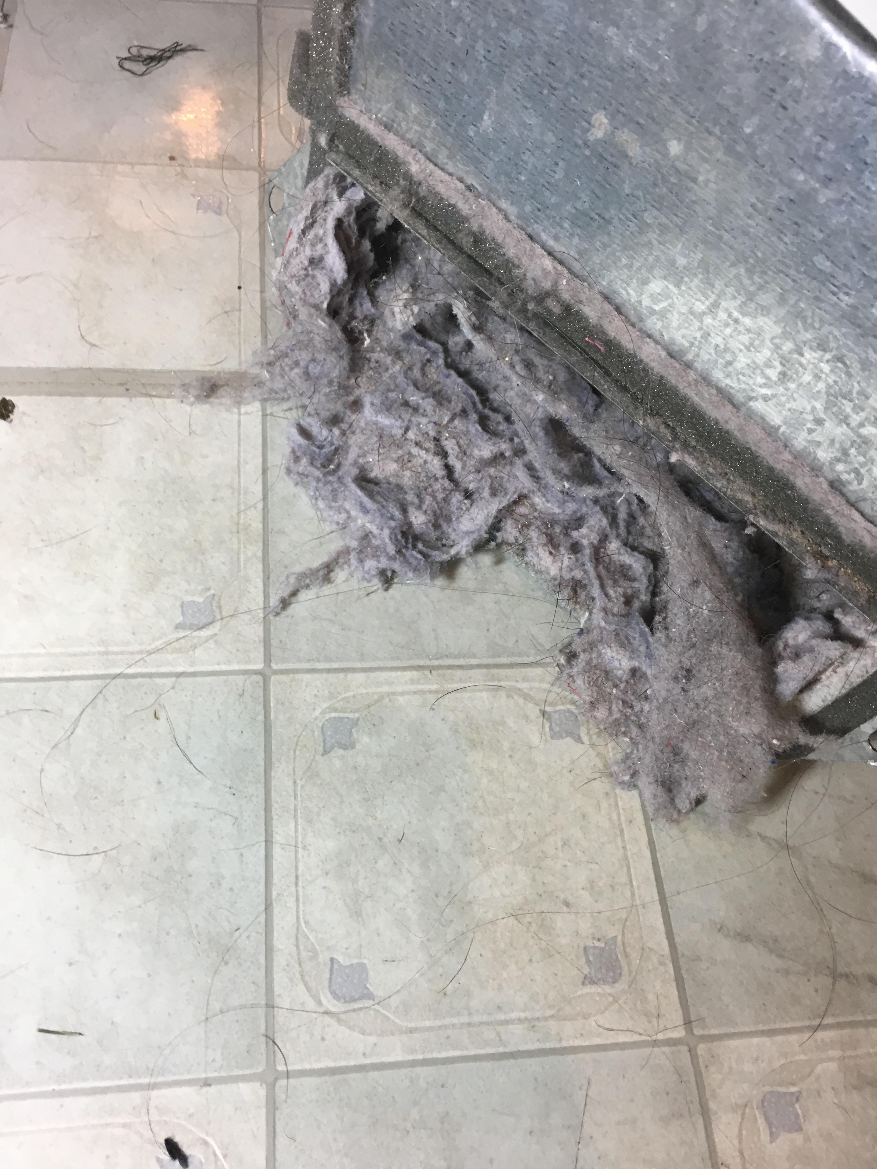

I’m happy to report back that the dryer seems to be finally fixed! Finally the check vent light is not on and the good light is on :smiley:
The front bulk head was clogged. I always clean out the removable lint filter, but there was a substantial build up of lint on the bottom of the front bulk head. Could not see it or get to it until it was removed from the dryer. Here is a picture:
Once I saw that, I was pretty sure that was the cause. However, I continued on to make sure the blower wheel looked good and was not clogged. It did look just fine. Here is a picture of that:
Great I am glad you solved the puzzle.
In my opinion a likely cause for so much build up may be the back pressure on the system due to the long vent run with so many elbows. The belt driven fans as you have are not as powerful as the fans connected directly to the motor.
You will likely run into this problem again in a year.
Keep in mind the lint build up presents not only a drying issue but also presents a fire hazard. Hence the reason for the building codes mentioned earlier.
Installing the vent booster should help prevent the buildup of lint and prevent downtime, overheating of the unit, potential broken parts (i.e. heating element, thermostats, etc) increase drying efficiency thus reducing drying time saving on electric cost and as stated before reduce fire hazard.
