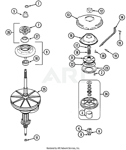

Maytag Advantis 12002213 thrust bearing kit ..installing and there is NO room at the bottom of the shaft to put the c clip on. I have verified no old parts left in the bearing is tight with spacer, the cam is aligned, pulley pushed in all the way

I have a more updated thrust bearing kit…because I don’t have a lower race waster and the two upper race washers. I have a metal thrust bearing peice and a plastic spacer … I snap those pieces together and then put on pulle with the white lower cam.. the thin washer… and then supposed to be the c clip/retainig clip.. but the groove is not exposed for this last step to happen.

I always found it easier to use a screw driver or two to wedge between the casing( the part that has all the black stuff on it) and the brake rotor itself( the part with the 6 ridges) and lever up against the brake rotor until it disengages just a little from the case and you should be able to get your clip on. One word of warning, use a strong screwdriver or prybar and you might want some help, there is a very strong spring holding the brake down

I’m experiencing this exact thing with the 12002213 kit and my Maytag PAV3240AWW! The plastic insert that fits onto the replacement bearing seems too thick relative to the metal washers it replaced, pushing the pulley down the shaft to the point that the plastic insert with the arrow sits taller than the axle. Cant fit an e-washer alone much less a thin washer + e-Washer. My attempted repair sits idle until this gets resolved - HELP!
The only thing I can tell you is that you have to get the brake free from the cradle, That spring tension pressing down is tough but you can overcome it. Once you get the spring depressed even a little you should be able to install the e clip
I’ve taken the tub out and it’s upside down now. the pulley wheel sits so far up the axle that turning it has no effect on the axle position at al. Are you saying the brake spring is wound up pulling the axle into that assembly? If so, how do I unwind that to release the axle?
The brake spring is behind the brake pushing it down. The cam on the shaft of the pully engages another cam so that when it turns the brake disc is pushed up against the spring. That disc is directly below the pulley if you have it flipped over. If you can get that disc to move in even slightly it will give you enough room to attach the e clip on the shaft. The best way I found to do it was by using a pry bar or large flat tip screwdriver to wedge between the brake and the housing that surrounds it and pry it down. in the image attached the brake is part # 21, the spring is part # 18 and the brake housing assembly is part # 22 &23. The pulley assembly is 24.
