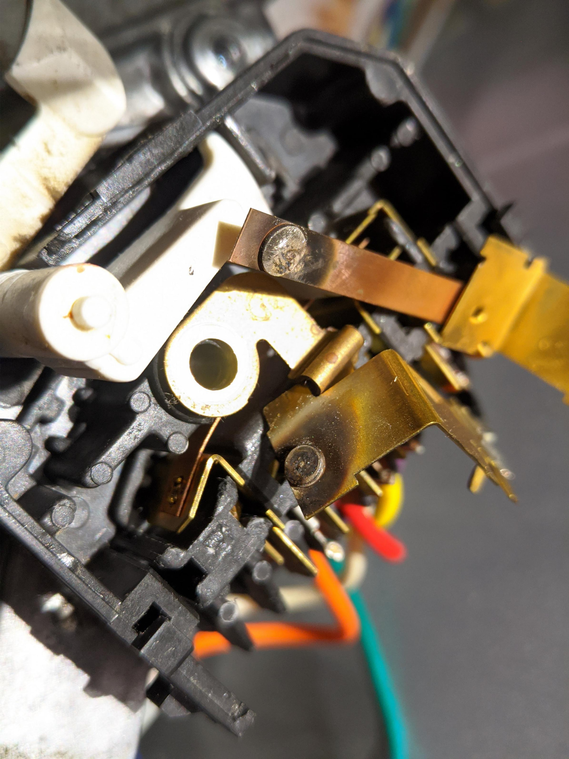

I removed the cover of the start switch on the motor and noticed the points for the first stage have some discoloration/blackening. I used a bit of sandpaper and isopropyl alcohol to clean the contact surfaces a bit. It did not seem to make a difference.

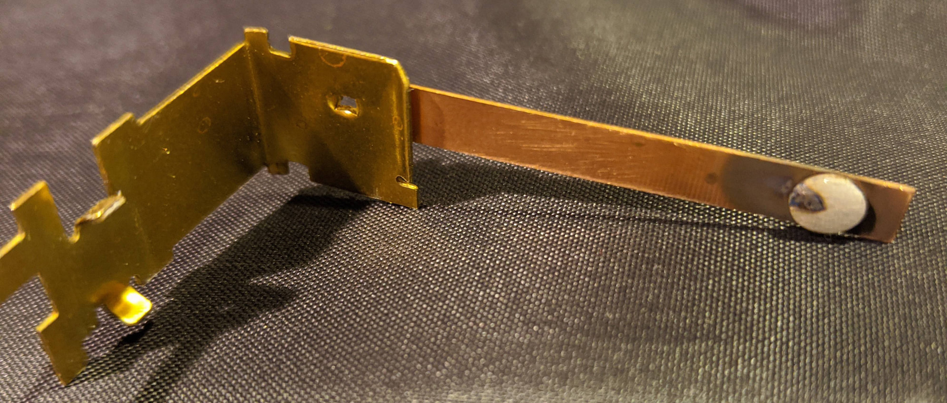

I noticed the contact points in the switch box screwed on top for the motor were blackened:
I cleaned and smoothed them with fine sandpaper and isopropyl alcohol. Blackening reappeared after a few attempted runs.
