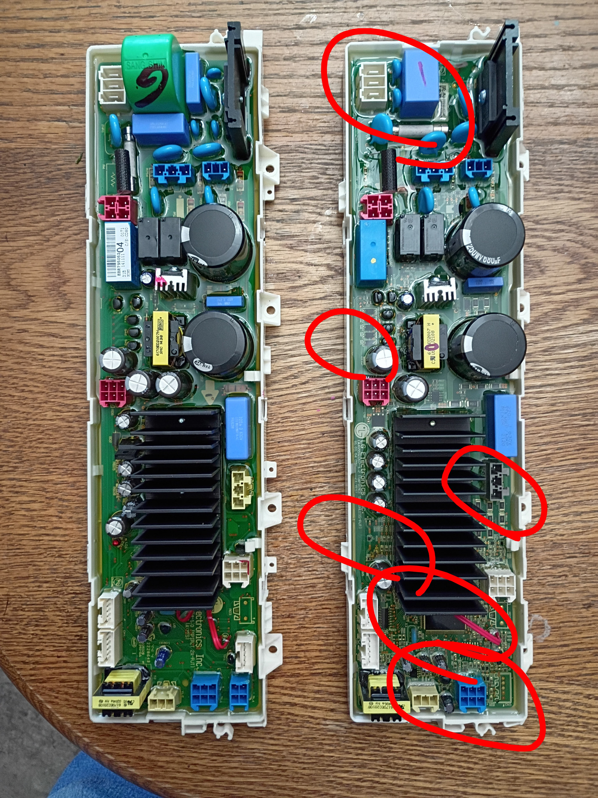

It sounds like this is a control board failure. With the power cord unplugged, the console can be removed to access the main control for testing purposes. There will be two screws, one under each of the rubber plugs at each side of the console. Once they are removed, the console should lift up. The main control should have a 6 port connector with a white wire at pin 4 and a white wire at pin 5 (see attached image). With the wire connection disconnected from the main control, the two white wires can be used to test the lid switch for continuity using a meter. It should have continuity when the lid is closed, and no continuity when the lid is open. If the switch tests good, the main control is not reding the lid status properly and would likely be the primary cause of failure. EBR80321804 Washer Main Control Board Assembly | Genuine Lg OEM In Stock
Thanks, William. As I was looking for more information on this, it appeared to me that it is likely the board that needs replaced. Thank you for the follow-up and information pertaining to the repair.
Hi William, turns out, the board that was sent doesn’t match up. There are several differences between the boards. The board on the left is mine.
Talked with Julius and it appears it’s the correct number for the model number of the washer.
I understand updates occurring and changes to boards can be made, but this is missing a plug-in at one end and one of the connections is a different style plug-in, alongside the board, where the shape of the connector is completely different and it’s a different color. Is my machine too old and it needs an older board?
It looks like the original control is part number EBR79505204 which is an older control and it would be the one you would want to use in this appliance. Do not install the control EBR80321804 so that it can be returned.
Thanks, William. Do you have a link to that EBR79505204 board?
This link will bring you to the information page. EBR79505204 Main Pcb Power Control Board Assembly | Genuine Lg OEM In Stock
