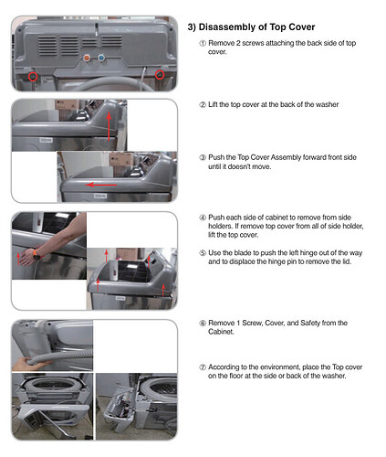

lol… watched the video, and that guy made the steps of inserting the putty knife and lifting the top of the housing look easy. But he actually skipped the bit where you have to wrestle the damn top open. I can get the top up about 1/4”, but even deploying my very strong young adult sons, we are unable to pry the (insert angry expletive here) top up any further. HELP!
Well, that’s ENORMOUSLY helpful, thank you! Sure wish I had this info before wearing myself out last night! ![]()
