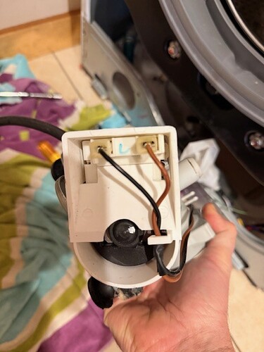

LG Washer Dryer combo WM3997HWA drain pump motor assembly wires crossed?
Brand: LG
Model Number: WM3997HWA
Main Symptom: Won’t Drain
What happens & when: Replacing drain pump motor for 3rd time in 5 years
While replacing this motor last time, I noticed the wiring on my pump motor is exactly backwards from the one shown in the APP video (see attached pics). When putting it back together, I decided to put it back the way I found it black on N (left) and Brown on L (right) - (in opposition to the video Brown on N and Black on L). Not sure at this point whether it came this way or I reversed the wires at some point in a prior replacement. What I can say is the pump as wired (in opposition to the video) worked for 2 years. I have seen other minor variability between the video and my machine. Is it possible the wires on my machine are supposed to be black on the left and brown on the right, meaning I should put it back together the way i found it. OR, is it possible this has been wired wrong and is eventually creating my drain pump failure. I am looking for advice on which way to wire this motor - as it was wired, OR as the video indicates it should be wired.
My Pump Motor:
APP Video of Pump Motor:
One wire is going to carry voltage and the other one will be the neutral path back to the source. If you want to know for sure which wire is voltage and the other is neutral, take the wires off, use your meter put one probe in one wire, touch the other to a meal base. Put the washer in drain mode and look for voltage. If no voltage, that is neutral, if it show voltage, that is the L1 or voltage wire.
actually both wires (Black and Brown) register volts moving through as soon as i power up the machine, before I start a drain cycle.
If you remove both wires and leave them disconnected. Put one probe in one wire, touch the other probe to the metal base. Only one wire can have voltage, but not both; that would mean you have 240 volts to the pump.
