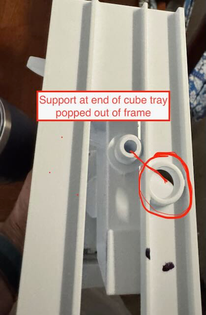

Purchased a new ice-maker from APP. Received a damaged one. Thought it might be okay after spreading the ice-maker frame and moving the cube tray support into the hole where it belonged.

FYI - Here are the two pics of the new ice-maker showing the ice tray support out of place when I received it and how it looked after I popped it back in place. The motor that attaches to the bucket full arm and the ice tray is much, much looser on the replacement ice maker than on the original ice maker.
