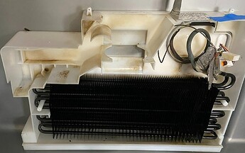

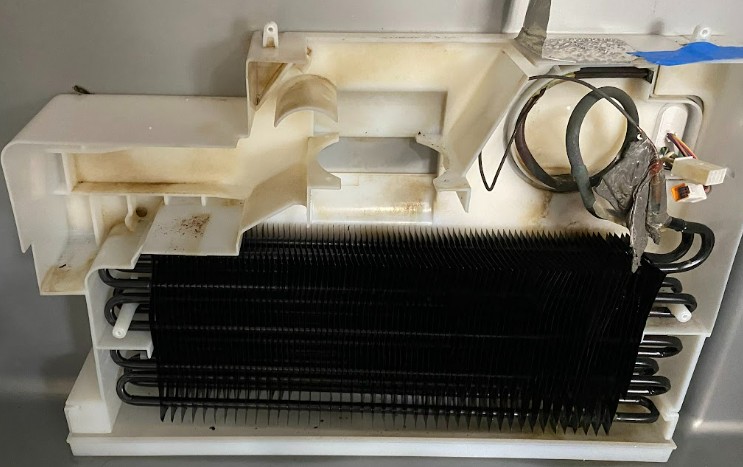

  1. Evaporator fan: When I put it in diagnostic mode, I couldn’t hear the evaporator fan in the refrigerator compartment turn on. However, I could hear the evaporator fan in the freezer turn on. After I disassembled the fridge, I tested the evaporator fan with a multimeter for both continuity and resistance and couldn’t get either.

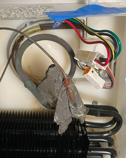

  3. I’m assuming that the thin metal wire that is attached to the evaporator coil is a temperature probe that measures the temperature of the evaporator coil. The plastic tape and insulation appears melted. Is it a problem?

Thanks for the response. The damper control assembly works. I updated my original post. The only question I have remaining is what to do about the temperature sensor (?) in the picture that shows the brown/gray tape. Thanks.
The thermistor should attach to the cover of the evaporator.
Update: the brown tape was covering insulation tape. The insulation tape insulates the point where the refrigerant in the thin copper tube enters the large tube in the evaporator coil. If not insulated appropriately, this apparently can lead to condensation and ice buildup. I reinsulated it with fresh insulation tape and wrapped it with HVAC tape. I also replaced the evaporator fan. The fridge is working wonderfully now.
