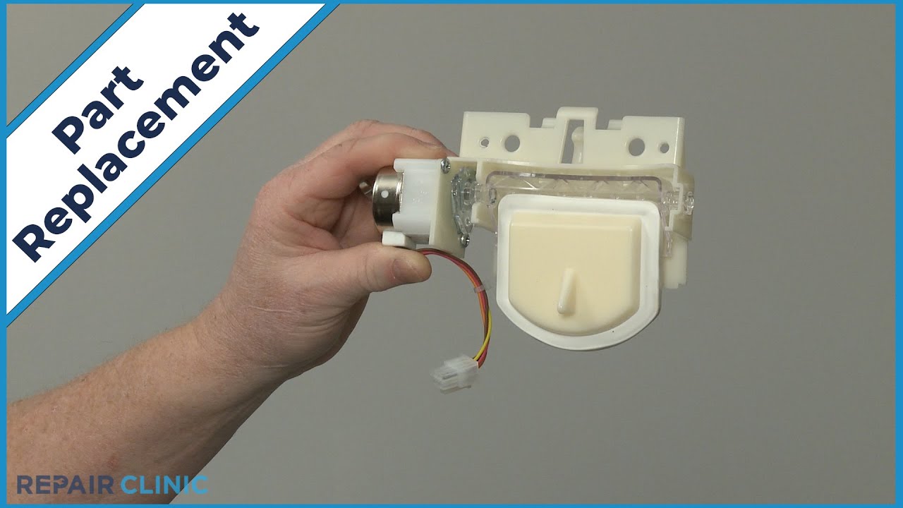

Also there is a Ice Door Flapper motor starts opening when the paddle is pressed but I reached up and found it’s really dirty and a bit moldy around the seal.
So I think there is a switch on this flapper motor that says when the flapper is opened to allow the ice auger to start.
But I can’t figure out how to get access to it so I can clean it or replace it.
I found how to remove and replace this flapper. Removing the front plastic touch screen was not easy. And there are two pieces to this panel. You need to remove the larger black frame, not just the front thin touch screen.
Here’s the instructions….
Well I’m stumped. The flapper was really moldy so I cleaned it up and put it all back.
When I press the lever for ice the flapper motor runs and the flapper opens properly but the auger does not run to dispense the ice.
