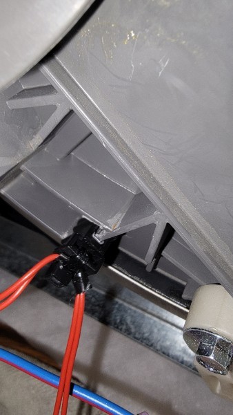

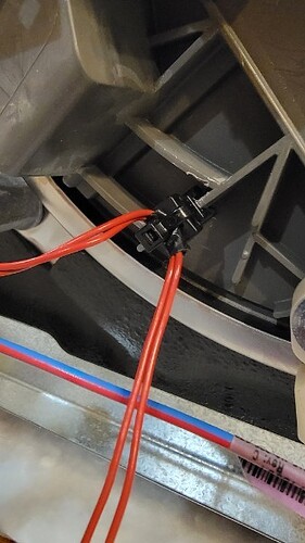

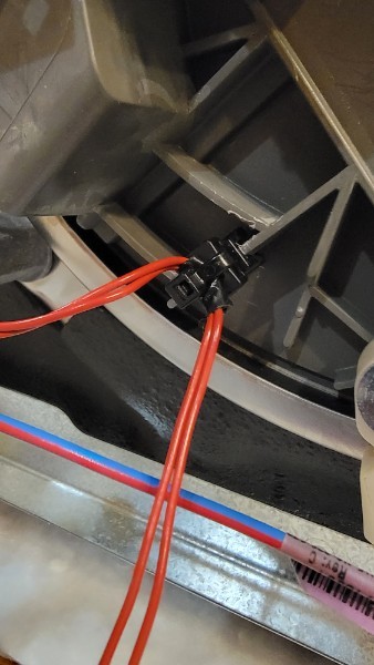

We ordered W10907618 (part #2) for our Kenmore Elite 665.14833N510 dishwasher. We are stuck removing the old sump. There is a wire attached to the bottom of the sump terminating at the Pump Diverter Motor. I can’t remove the sump because of this wire attached to the sump. How is it attached? How do I remove it? There is no clip there on the new replacement part. See photos.
It looks like that clip can be removed by pulling down on it and wiggling it to remove.
