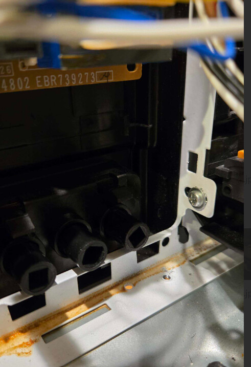

What happens & when: Door button pushes in and pops back out but doesn’t release/open the door
Error Code (if any): none
Parts or tests already tried: microwave door release lever appears intact but doesnt stay in place; no obvious broken pieces inside
current door release lever
button pushed in without door release lever in place
buttons released
attempt to reseat door release lever but it doesnt stay in place
No issue with door latch
Any help to determine what part is needed would be appreciated! Worked perfect before the door stuck so hate to add it to the landfill. Thank you for reviewing my issue!!
One thing I do not see is the 2 springs ( LG 4B72023B Microwave Spring | Genuine OEM Part ) that go between the button and the release lever ( LG 4510W3L003A Microwave Door Release Lever | Genuine OEM Part )
I do not see them either, but tension on the button seems ok so i didn’t take them out. It looks like those springs go on the black cylinders so they do not touch the white lever?
Yeah but they may help keep everything in place
when the button is released, the cylders pop back in
I meant cylinders. They do not seem to touch the lever unless the button is pushed in. Something broke somewhere because it was working, then sticking now not working at all. I did not see any loose parts inside when I opened it.

Aha! I moved it around and found the broken piece.
It looks like it should be where the tip of the pen is. This is part of the black plastic frame that has the menu buttons and door button.
I
Here is the part number you need but it is no longer available. You may be able to find it on a third party site ( LG MGC61944602 Microwave Control Panel | Genuine OEM Part )
