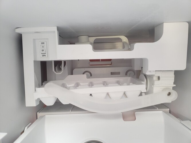

My icemaker only has an on/off button. Nothing more.
You can try turning it off then back on to reset it. If there is no ice in the tray it should advance to the fill step pretty quickly

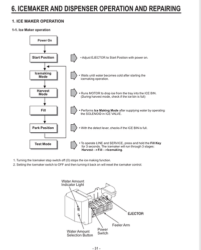

There is a test button on your icemaker see attached sheet
I located the test button. Thank you. I pressed it and the tray went through its paces but still no water. Do you think there is an issue with the valve?
Did you hear it buzz like it was trying to send water? Check for 120v ac at the valve when you trigger the test cycle.
I don’t hear any buzz when doing the test cycle with the test button. I put water in the tray manually and the water freezes and ejects the cubes but still no water from the fill tube. Is there any way to open the valve manually to fill the tray?
Yes disconnect the line from the valve to the icemaker then press the test button to see if water comes thru the valve when the ice maker calls for it in fill cycle

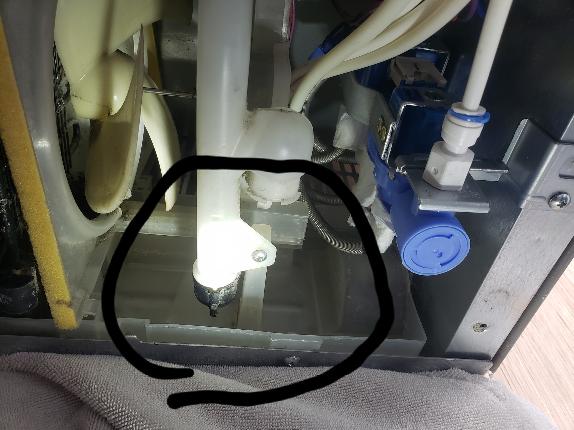

I have one additional question. I am getting about 1/3 cup of water draining into the pan under the valve. It is coming from the part to the left of the valve. I am worried that it will overflow and cause damage to my floor. Why is this happening?
