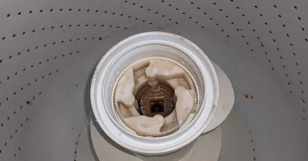

When I removed the upper agitator, there were no agitator dogs installed (and no sign of them at all!). I installed a new set.

Some pics and a video/audio of the noise are here:
Google Photos
