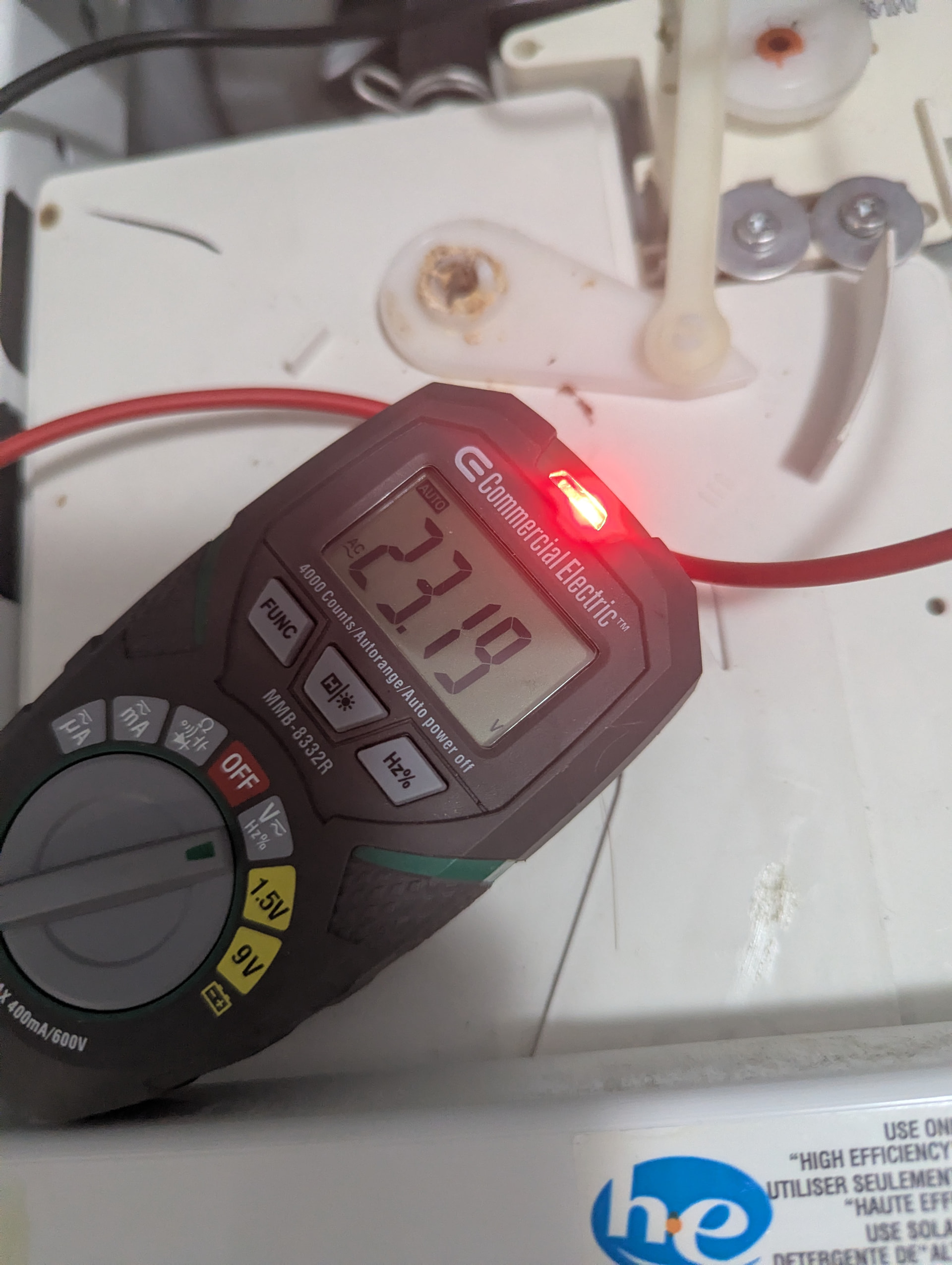

3. Water Valve Voltage: I unplugged the wire connectors and tested the electrical terminals directly during the silent period after hitting Start. One valve connector read 23.19 VAC and the other valve connector read 19 VAC. Neither reached 120 VAC.

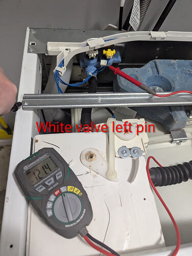

Did you test each side of the water valve plug to ground such as a bare screw on the cabinet

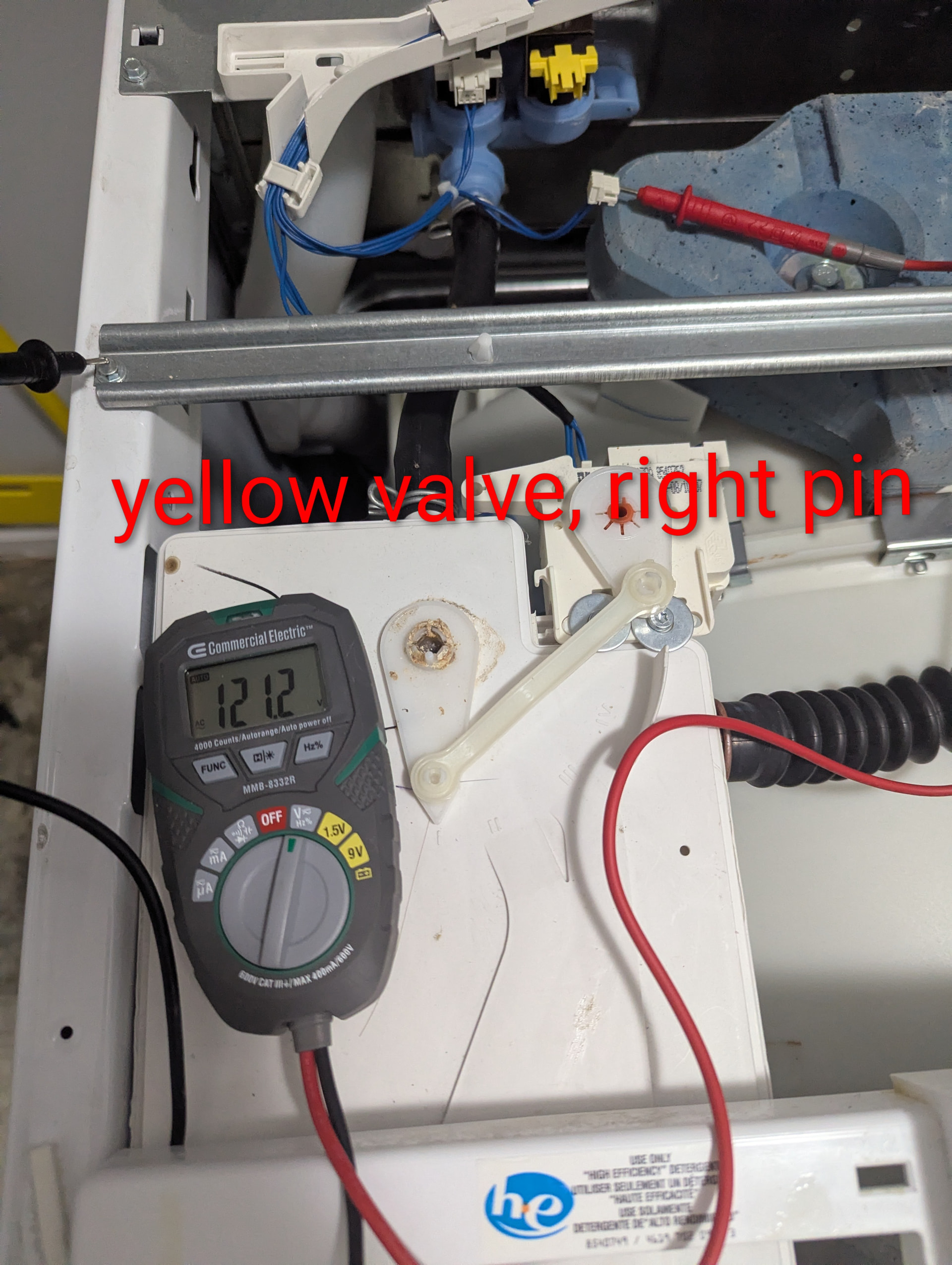

Update: I just reran the test to ground using a bare chassis screw. Here are the exact voltage results for each individual pin on the disconnected water valve plugs during the start cycle:
White Valve Plug:
Left Pin to Ground: 121.4 VAC
Right Pin to Ground: 28.20 VAC
Yellow Valve Plug:
Left Pin to Ground: 26.70 VAC
Right Pin to Ground: 121.20 VAC
Line voltage is fully present on one side of both plugs, but the neutral return side is not completing the circuit.
