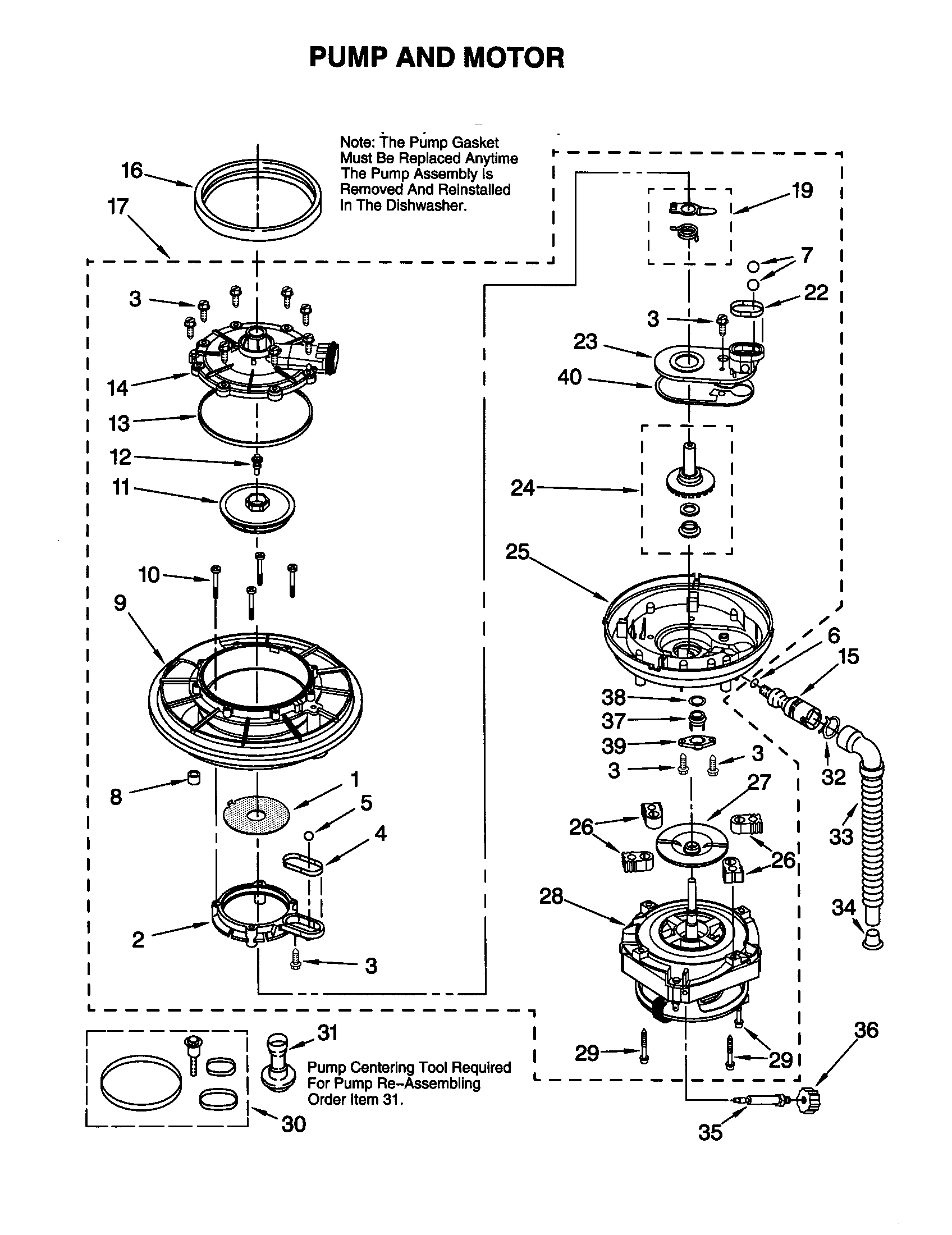

Remove the toe panel. Disconnect the drain hose (be prepared to lose some water on the floor) from the dishwasher. Unscrew the check valve (#15 on the diagram) and make sure it is clean inside.
OK, now the dishwasher is refusing to drain at all and there is quite alot of food being left on the dishes on both the top shelf and the bottom shelf. I removed and inspected the check valve (#15 on the diagram) and it was completely clean and functional. In fact I can blow through it and the valve will open.
By the way, this is not an issue with the drain hose. I’ve removed and inspected it and there are no blockages. It is routed correctly and per my comments from my orignal post, the unit will drain by pushing the cancel/drain button every time.
What items would you like me to check next???
Remove the pump cover (#14) and the filter (#9) on the diagram from the pump and inspect all impellers, the seal (#13) and the balls (#5 & #7).
