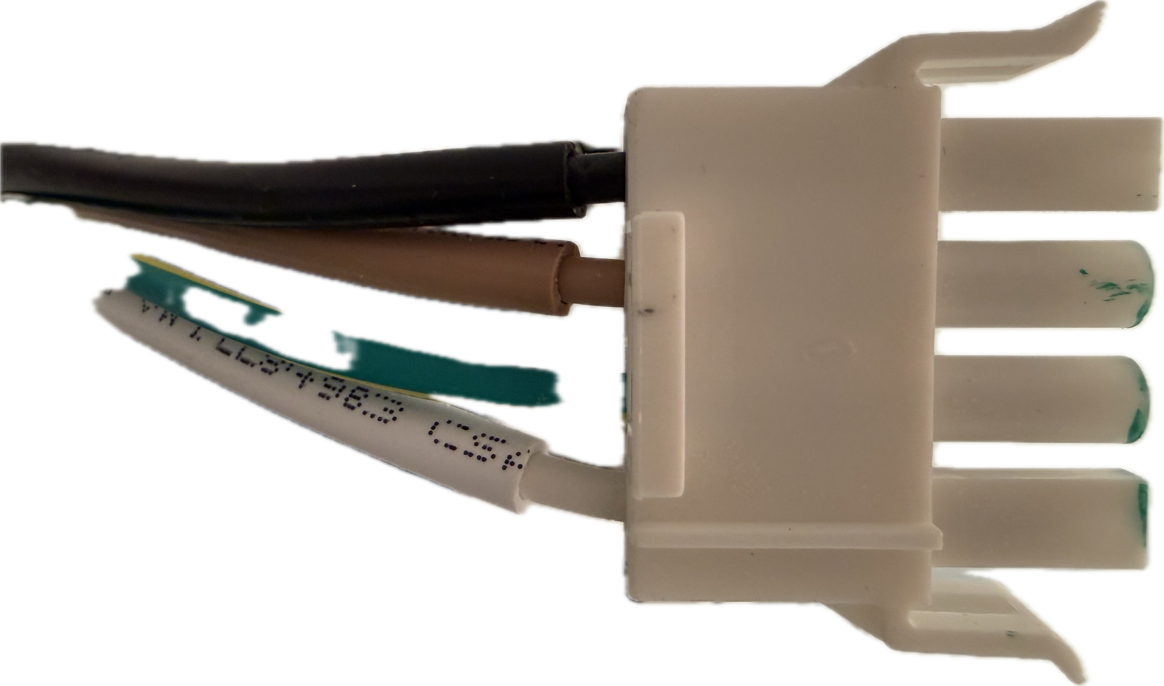

I own a multimeter, but I am not an electrician (not even close, for that matter.) So I had my electrician on the phone while I tested the voltage. In the violet and white, the reading was zero. So my electrician had me check the black and white, and the reading was 120. I hope that this helps.

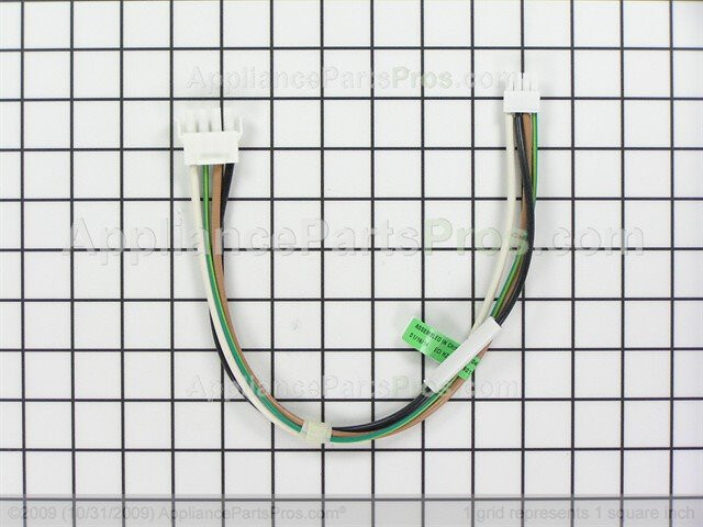

Were the black and white on a harness like the one below?
The first picture (far right side) is the harness receptacle on the rear wall of the freezer.
The second picture is the harness from the icemaker that gets plugged into the receptacle
I hope that those pictures help.
Yup, that’s the one, check the black and white wires at the other end where it connects to the ice maker for voltage.
Then, turn off power to the fridge, reconnect the ice maker harness to the wall and disconnect the ice maker end, and take a resistance reading on the brown and white wires.
Let me know what voltage you get at the ice maker and what that resistance value is from brown to white.

Yup, that answers our question. You’ll need to replace that harness.
That harness was on the icemaker that I just bought from Appliance Parts Pros.com
If you’re getting voltage at one end but not the other that means a bad harness, may wanna retake that reading and make sure the freezer door switch is taped or held down.
I taped the freezer door light switch down and tested the black and white coming out of the back wall of the freezer and got a reading of 123. I reconnected the icemaker harness into the back of the freezer wall receptacle and tested the black and white on the end that connects to the icemaker and also got a reading of 123.
